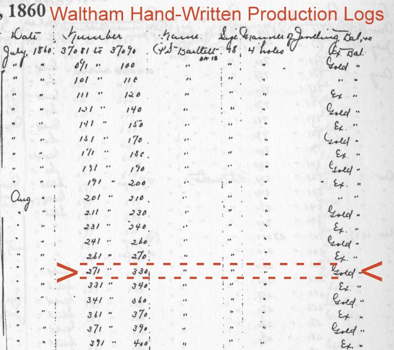

It is a Gold wheel! I scanned the written record of Waltham July 1860, FIRST YEAR OF AMERICAN WALTHAM WATCH COMPANY PRODUCTION! and it shows for this s/n 37272 that this watch was part of a production of TWENTY (20!) P S Bartlett Model 1857 finished with SOLID GOLD Balance wheels! Cool , Furthermore . . .

Meggers Ehrhardt discuss this VERY EARLY model 1857 movement with the UNDER HAIRSPRING REGULATOR, and tie it back to the FIRST model 1857 18s design made by Boston Watch Co. In fact I would bet that some of these (Swiss made, etc.) parts were from 1850-53 Boston W. C. Inventory.
