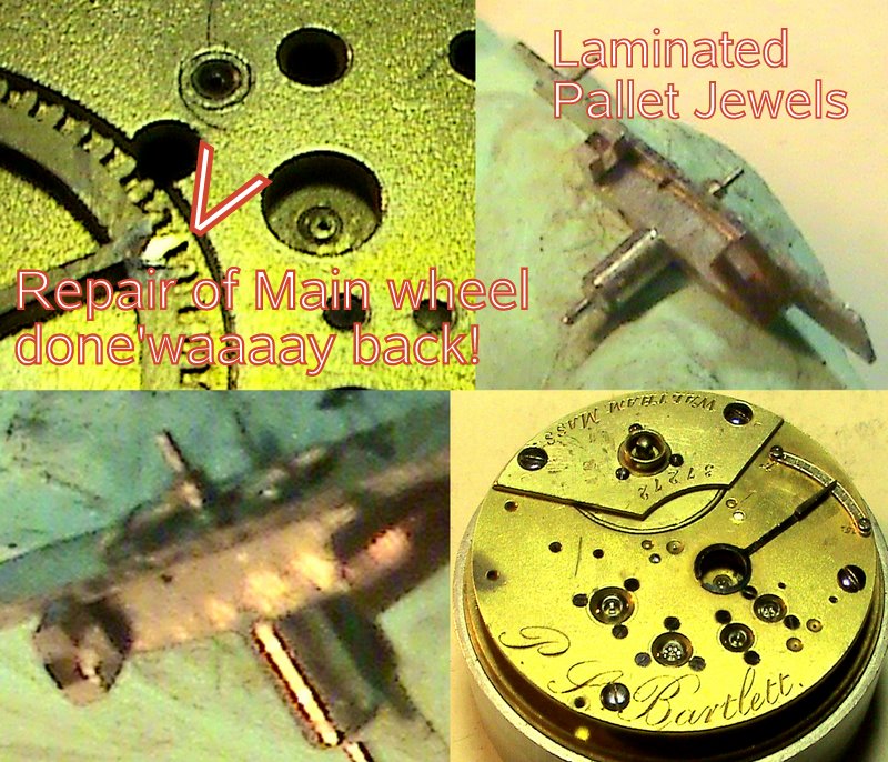

This week I took some time to look into it. . . WOW Eek I NEVER know that Waltham had laminated pallet lever Jewels! Some "discoveries" which I was cleaning and inspecting . . .

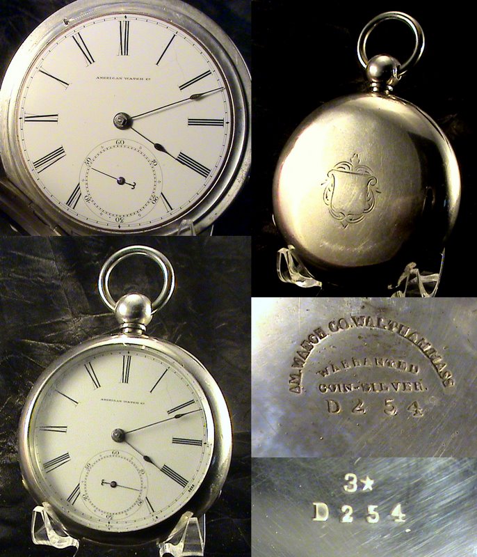

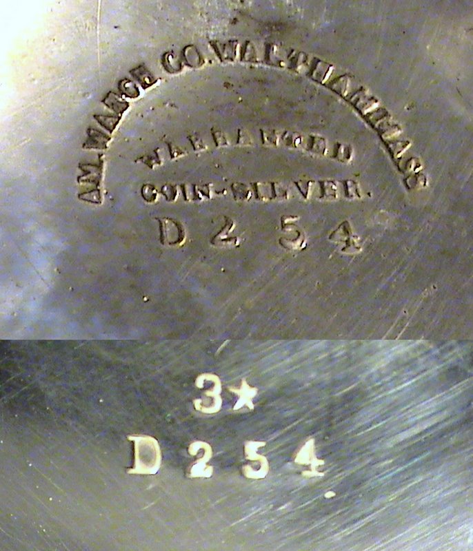

After a trip through the cleaner and some more time on the parts, I dug up the case . . .

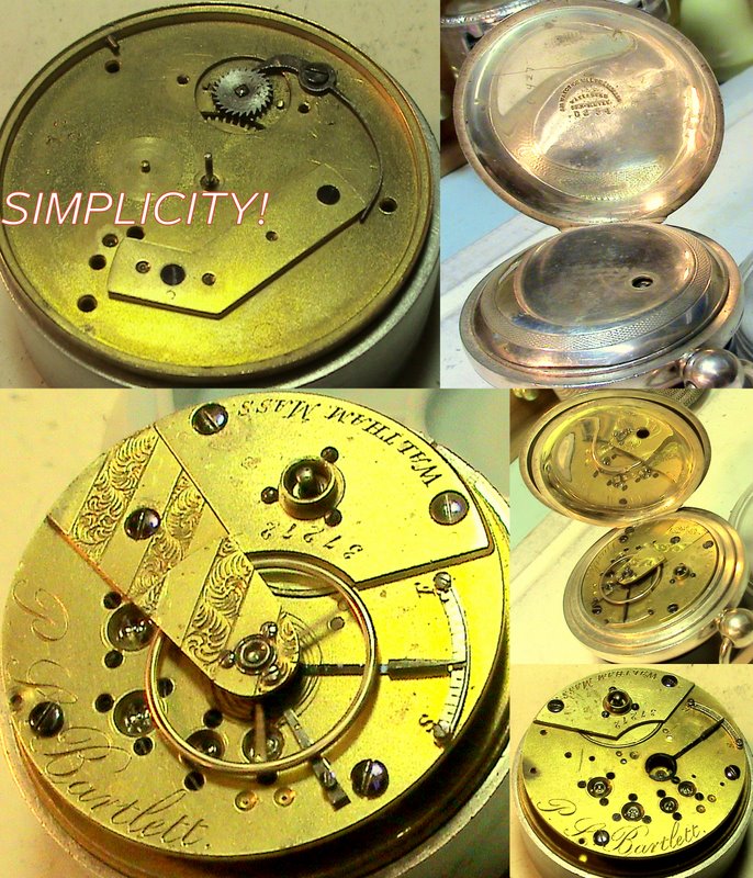

With that in hand, I began the task of checking and adjusting those few things these utterly simple time pieces require. Nice wolf-toothed click wheel . . . Is that a solid gold balance wheel . . . it sure ain't "white steel" color!
October 13, 2010, 20:13
But after removing about 2 pounds of rust, and a lot of old ossified fish brain oil, the movement loves its residency inside a proud Coin silver case that looks like it could have held this from the beginning!
This watch is running proud. Could have seen an officer through the war between the states or run the railroads that Cornielius Vanderbult worked so hard to extend down from New York and Ohio to Washington DC the for the effort. It is still running very accurate! (around 16198-16202 bph)

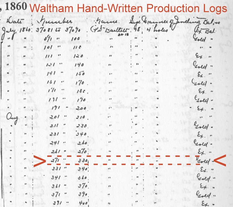

It is a Gold wheel! I scanned the written record of Waltham July 1860, FIRST YEAR OF AMERICAN WALTHAM WATCH COMPANY PRODUCTION! and it shows for this s/n 37272 that this watch was part of a production of TWENTY (20!) P S Bartlett Model 1857 finished with SOLID GOLD Balance wheels! Cool , Furthermore . . .

The English side lever escapement was used on all Mdl. 1857 movements until 1874. The English pallets were covered where the the pallet stones are set in slots running in the plane of the pallet.

David you are fantastic! The laminated pallet jewels are new to me and I wish I had your talent. I am going to carry your wonderful restoration and just enjoy it. Many thanks friend.
