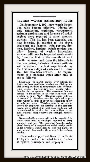

Here are some watch requirements from Sept. 1, 1921 published in The Santa-Fe Magazine; ![]() | |||
IHC Member 1291![]() |
As you can see even as late as 1921, watches could be "grandfathered" in and watch inspectors did have some leeway BUT the watches still had to perform or live up to the set standards for timekeeping. regards, bb | |||
