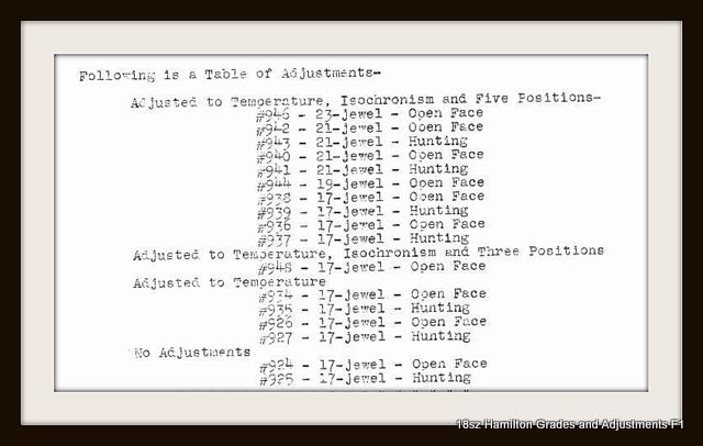

I would suggest that any of the watches that had a minimum of 17J and were adjusted to 5 Positions such as Gene's 964 O/F, and including your 937 H/C
To have a DSD fronting them as most of them "came" that way from the factory when a movement/dial/hands went out unless a "special order" for a seconds sunk only came in or when a movement only went out.
As to RN or AN on your early watch, use whatever you wish as both were in vogue.
Here are some 18sz. Hamilton Grades and Adjustments;

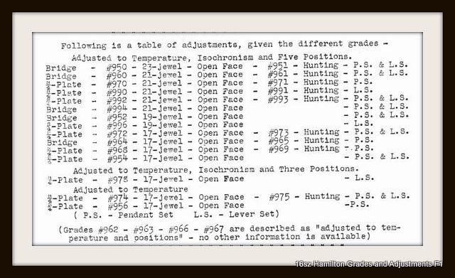

Here are some 16sz. Hamilton Grades and Adjustments;
