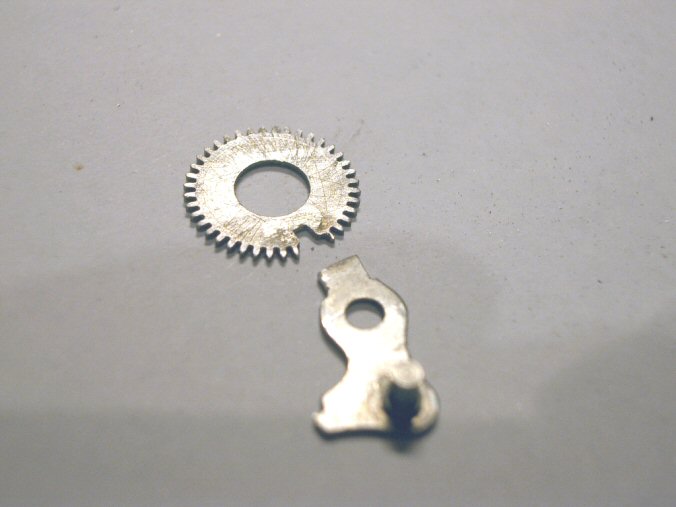

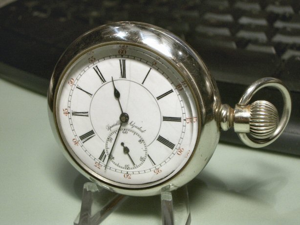

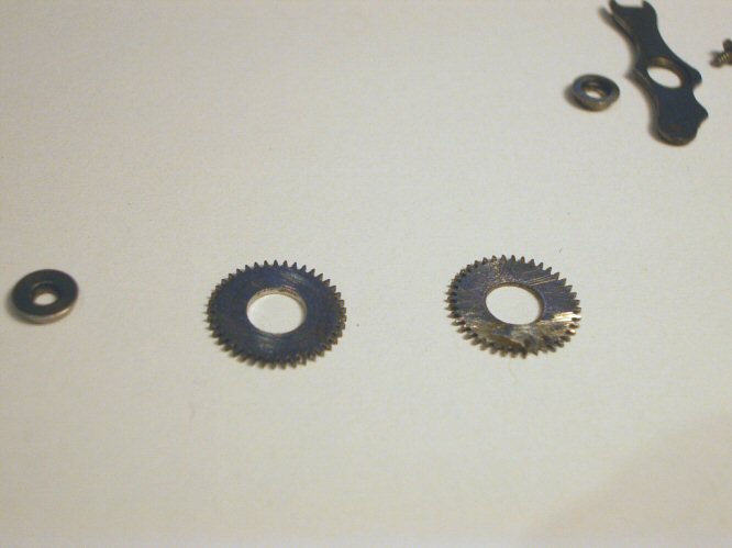

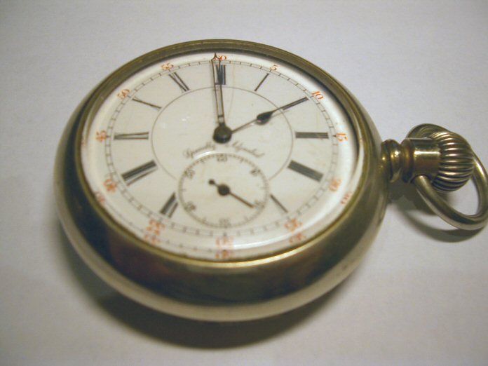

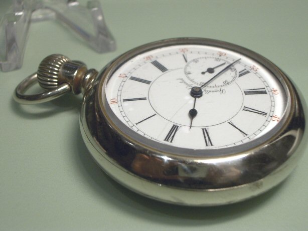

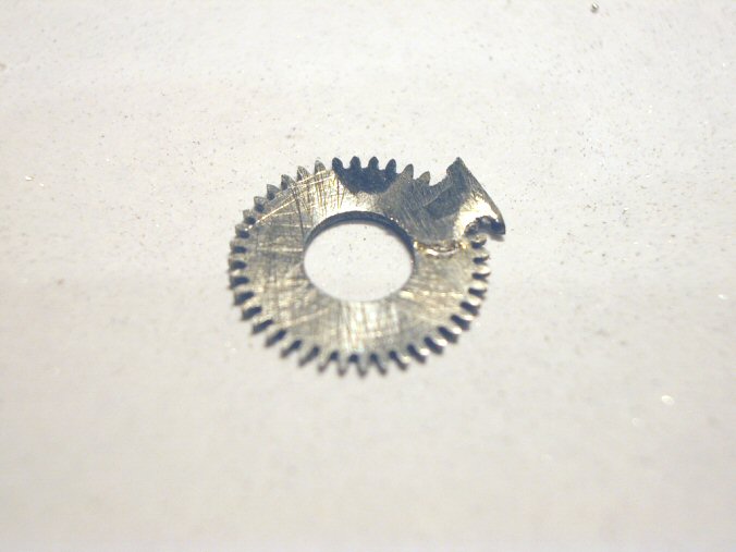

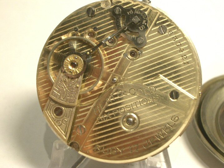

Hi, i buyed this 18s pocket watch, but i not know nothing about it. Im not sure is an American pocket watch, possibile swiss or english clone?
Thank you!

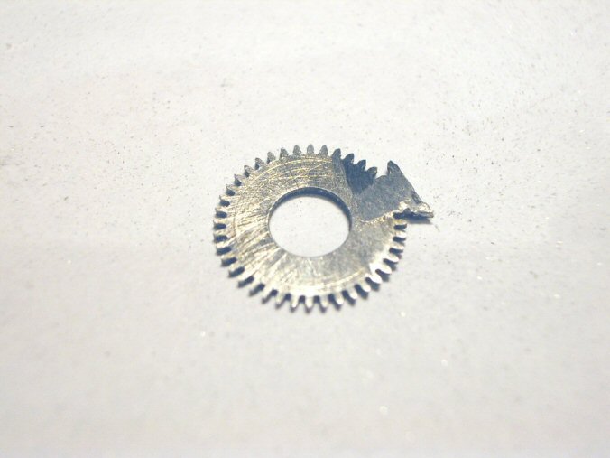

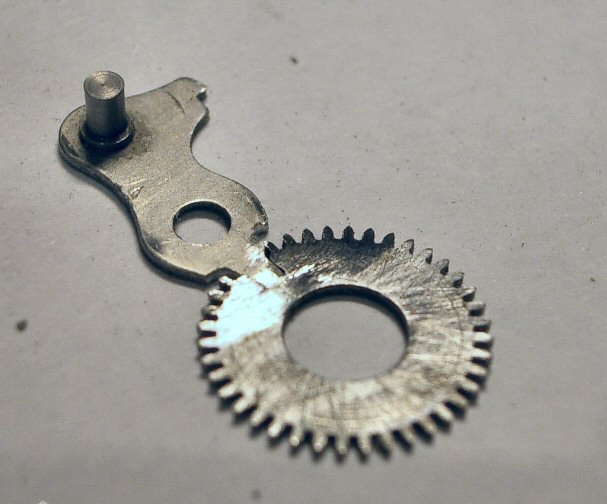

( Broken gear..)

Fabrizio,
My opinion is the overall watch has a "swiss fake" look to it. The overstated markings raise suspicions but the apparently non functioning regulator is a big strike against it.
I can't say for certain but I'm not sure that gear device is really damaged. To my eyes it looks like someone intended to cut it that way. Others may know for sure.

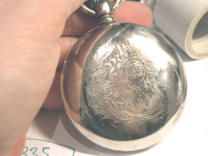

Fabrizio, that is indeed a swiss "counterfeit" US-style watch movement. The "broken gear" is a cut out part of the old wheel made when someone was attempting to repair it by soldering in a new piece of metal that they can hand-make new teeth for the winding gear. The case is worth 3 times the watch. I picture a swiss counterfeit that I bought for the case for your comparison.

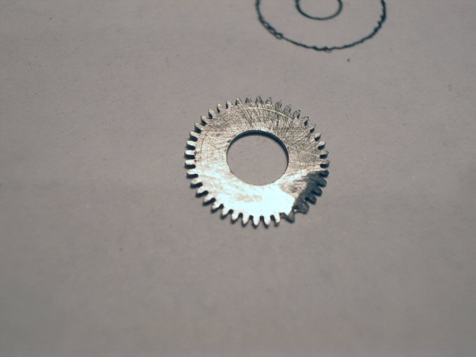

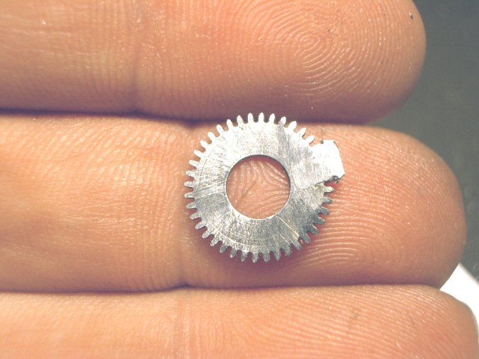

Movement is working, problem is only damaged gear, and is not compatible with elgin and waltham gear.
I will try solder it and to reconstruct the teeth.. not easy :-(

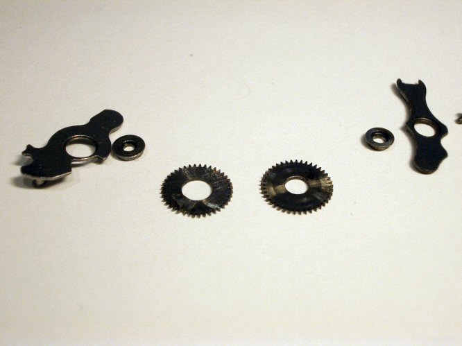

Fabrizio, I have two SDwiss Counterfeit "parts" movements that I will give you "free" if you will pay for the postage! Just advise your address and how I should send them. The smaller winding gear measures about 8.86 mm outside diameter and the larger gear measures about 11.6 mm outside diameter.

They are quite different on the Balance wheel side, but at least you get a lot of swiss conterfeit movement screws.

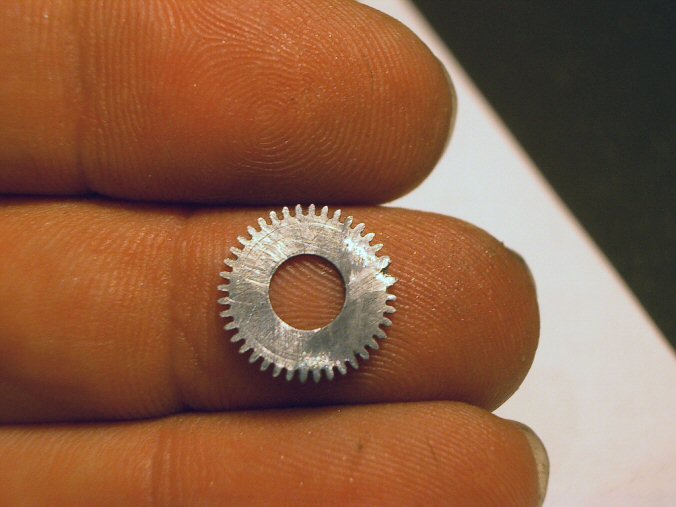

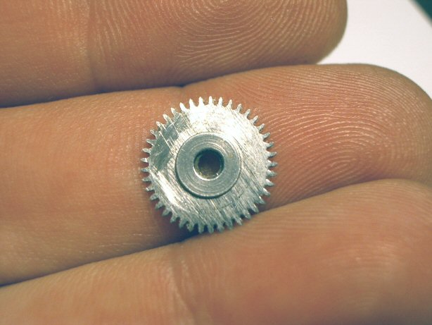

Hi David! My gear is outside 11,30 mm and hole inside 4,69 diameter, is the some of your?
Now i try fix it..
At moment i not tested the gear, i not think is good work. :-(

Fabrizio, I can send you the wheel. It should work for you because the thickness is 0.69mm. You can make that thickness corect for your watch very easily, and the 3.73 mm inside diameter and 11.45 outside diameter can be fitted to your watch! I would send you the complete watch movement and you could chose the parts to use to make yours work best!.

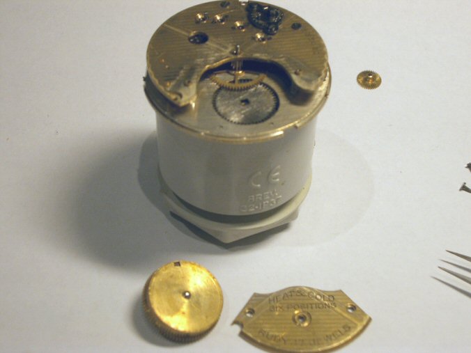

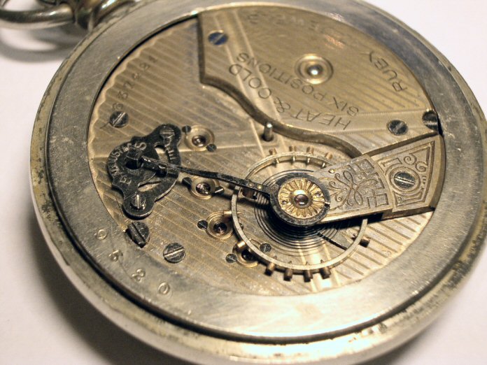

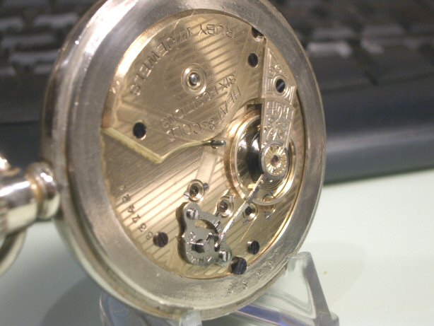

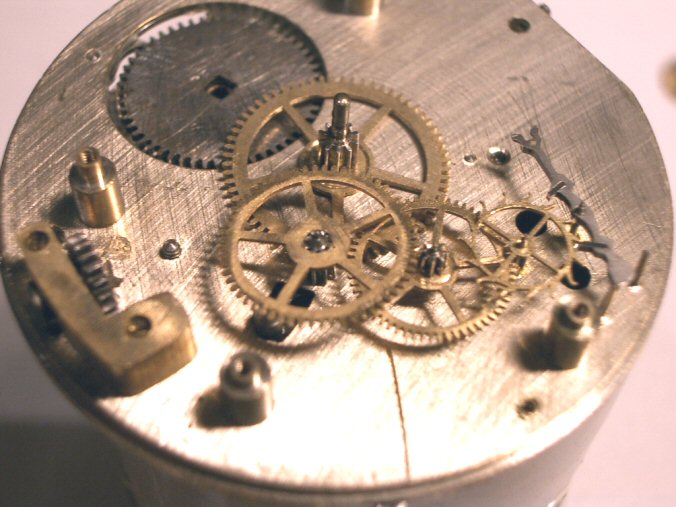

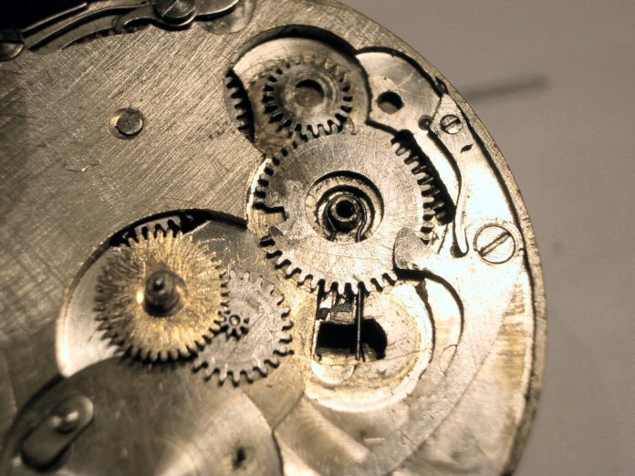

Today i restored movement, damaged gear work but sometime winding is locked and non free.. i prefer your gear :-)

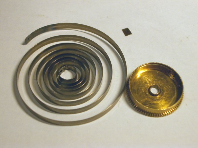

Now movement is clean and oiled.
Damaged mainspring, i fixed it..

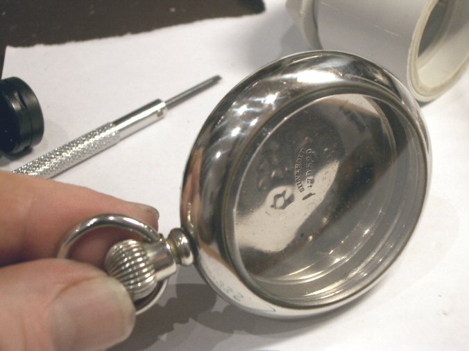

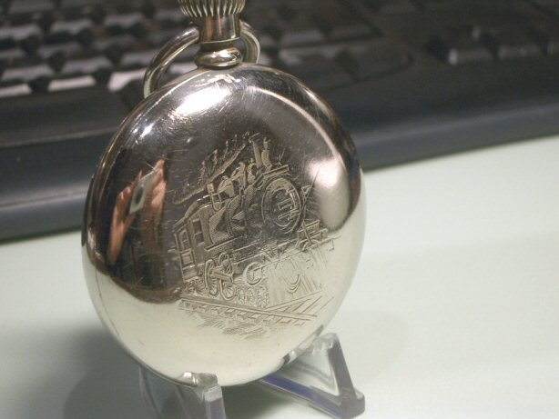

The case.

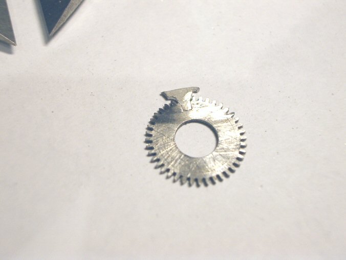

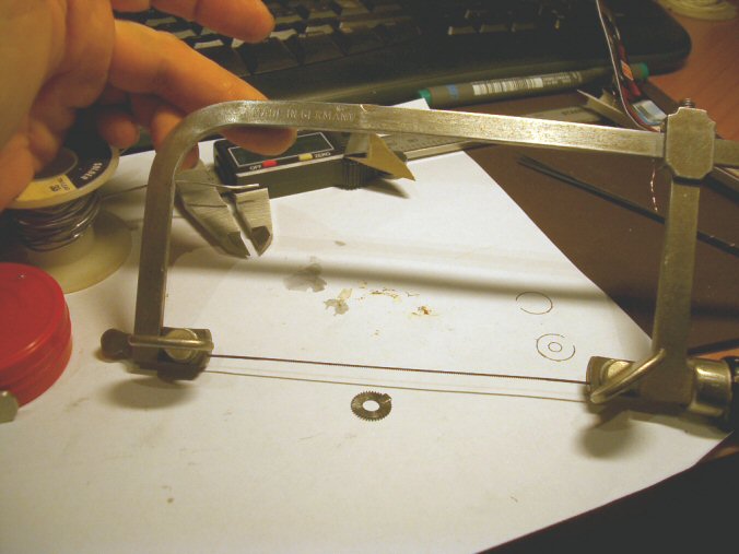

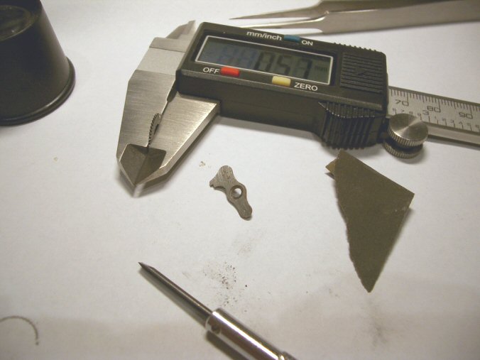

The repair looks great. i like your diligence. it is work just like this that helped bring about the name "watchmaker". How did you "solder" the piece into the gear?
I think that the repaired gear is "locking", from what i can see, because in the place of the 2 cut teeth there should be about 4 or 5. Of course i bet just cutting 1 of those teeth was not to easy.

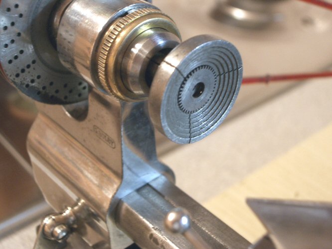

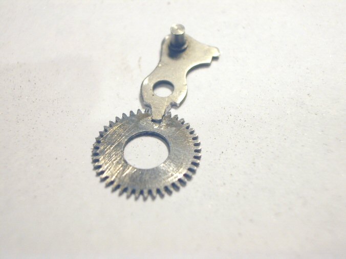

Hi, im electronic repair of alarms systems and security cam. ( im not a watchmaker, i like repair pw of my collection, is my hobby ), i used normal solderig for circuit and chips. Is a particular solder, i read TIN/LEAD 33 % the name of product is Super Solder the best flux corf.

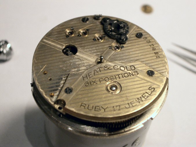

posted August 15, 2008 18:41

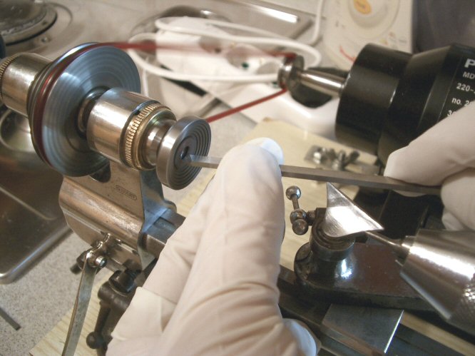

Many Thanks to David, i recived pocket watch with gear, a little modify and now is perfect! Wink
My work..
Left original gear, right David's gear, the center hole is little, i use lathe..
Now is perfect, thank you DAVID!! Big Grin
