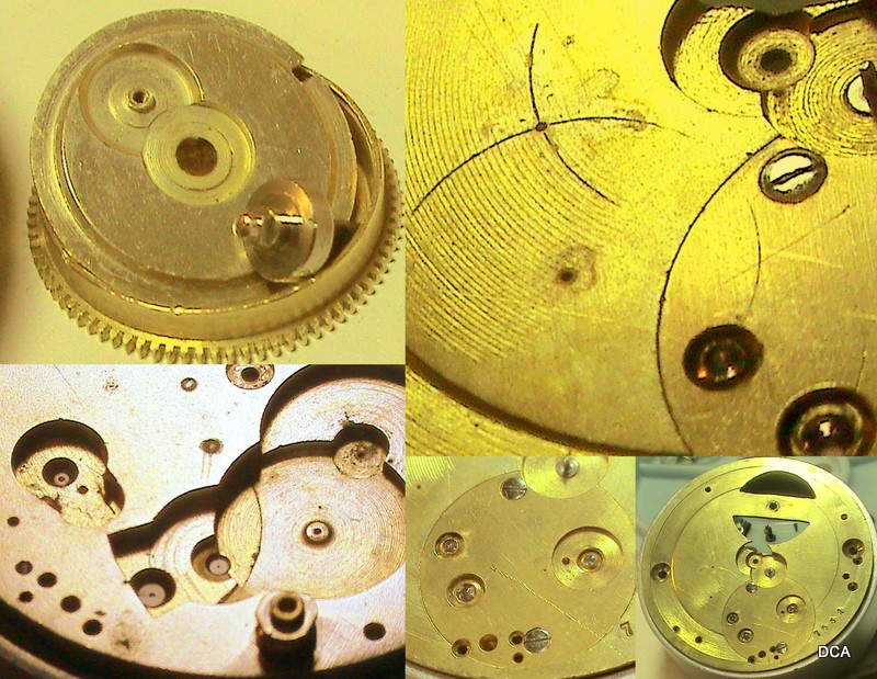

The second thing became obvious soon afterwards, this was a Hand-Made watch including Hand finished Escapement insert plate, layout compass scribe marks for the wheel train and a stopworks Motor Barrel! Hardly "Fake" work . . .

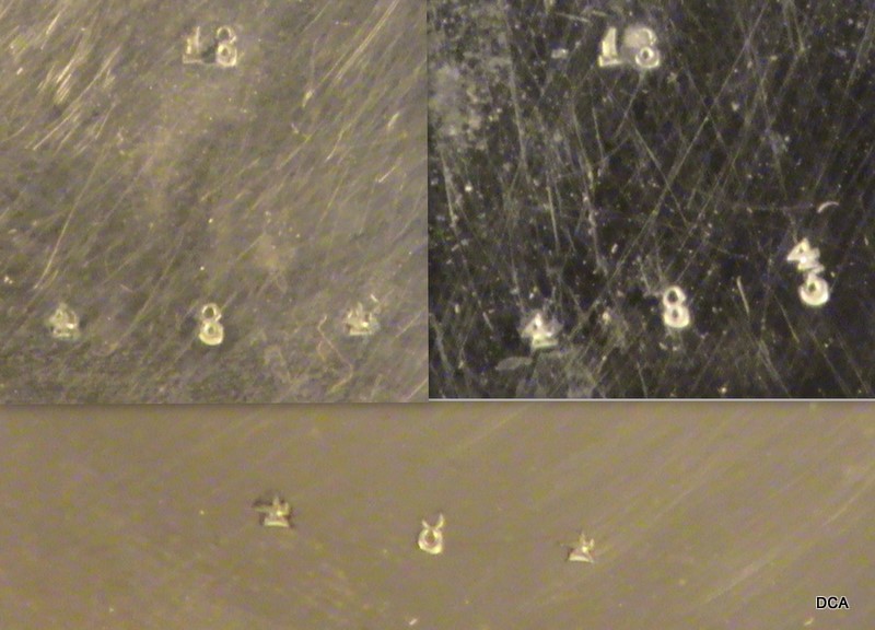

The 18K Gold filled case has all matching numbers . . .

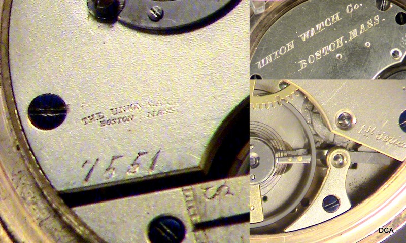

The plates are marked Union Watch Co., Boston, in two places, also marked "1st Series" and all the key components have matching "7551" serial numbers . . .

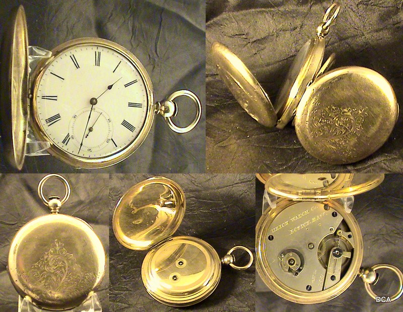

After finishing it up, all I can say is that a watch that is this old, presents this well, runs this good, and looks this "different" IS a Swiss watch, 1870 or so but IS NOT a "Swiss Fake" and hardly a "copy".
posted March 15, 2012 18:23
David-
Looks like a beauty all finished up.
