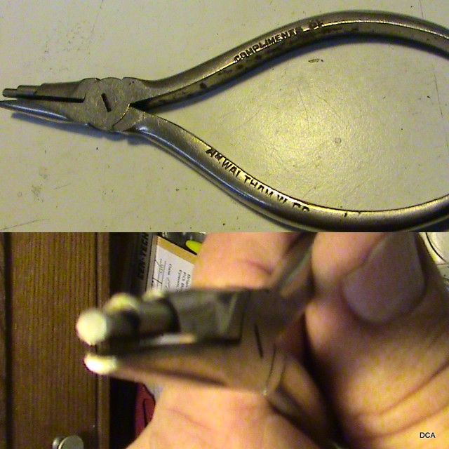

Coiling the inner coil around the arbor so the hook picks it up. Not as easy as it sounds, at least for me. I have broken new MS's after several attempts to get it to catch. How do you do it.

I have broke mainsprings like that also. What I do is before putting the arbor in I make the loop it fits in slightly smaller than the arbor with a pair of small needle nose pliers. Then I push the arbor in and turn it till it catches.

A pair of round nose mainspring pliers works best, if you can find them.

I use a small Jewelers pliers to compress the inside "coil" using the next coil out as a backup to keep from kinking the inner coil.

When you inspect your coil, the most important part of your work is the 180 deg "wrap" that keeps the winding arbor "tooth" engaged.

If you get lucky, you will find one of the wonderful little Waltham complimentary Mainspring forming pliers on eBay Pocket watch parts and tools. They are very good for "starting" the coil. Especially the "white steel" stuff which is very resistant to coiling.

Last time I did it like Jim said, only it was after I kinked it and bent it back. Hope it holds as the unit is running. Right now I am off to the Bay to see if I can find a pair of pliers as Brian & David mention, trying Brains site first then Dash to.

Patrick, my method looks to be what Dave showed in pictures. So at least I know I am not alone in doing it this way. Do as he has shown and it should work for you also.
