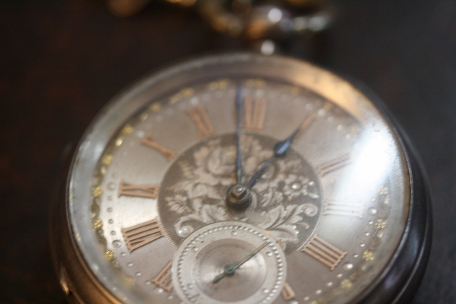

 Help To Iderntify Maker, Watch Year and Value Crystal is semi thick. Key Wind and Key Set Case is triple hinged Pendent where bow attaches is also stamped cannot read. .jpg) | ||

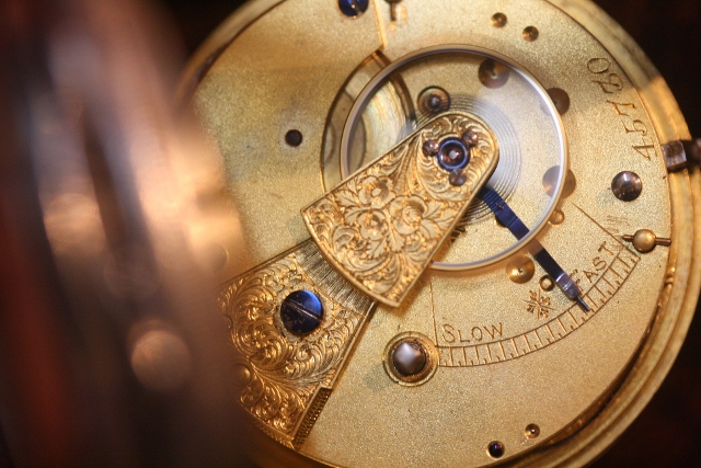

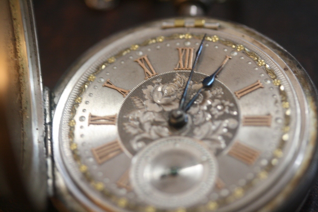

 Very Fancy dial.  See other pics .jpg) | |||

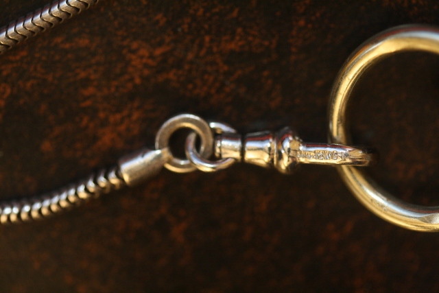

 Chain looks to be marked 12 KG, does not appear to be gold. .jpg) | |||

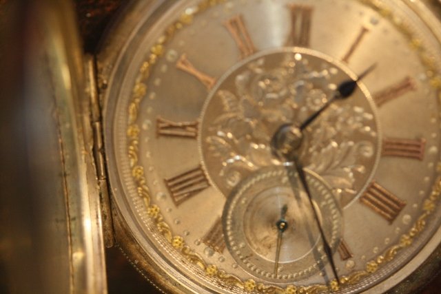

 Dial looks good .jpg) | |||

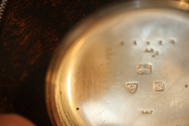

 Same marks back cover and cuvette Looks to have initials J.D on top of marks R.J.P. om bottom. The lion I think indicates sterling. The R possibly 1892 as the year. The other I don't know. .jpg) | |||

 hi david; could the chain be marked 12KGF?? | |||
 Tom It could be there maybe another letter there it is very hard to see and read. Were you thinking white gold filled? | |||
| IHC Member 1335  |
 often  the mark is 1/20 12KGF | |||
 TOM; You are right on. There is a 1/20 at the beginning had not noticed it before. | |||

 The sterling marks are for Chester England and the capital R is either 1835 or 1900, I can't tell which, part of it is determined by the shape of the symbol the R is stamped into. | |||
| IHC Life Member  |
 My thought is that a Fusee with pinned plates is more likely 1835. It is definetly English made probably form a panoply of Swiss and English mmaterial. | |||
 Thanks for all input on the watch.  I have found out a few more things since posting this and after hours of chasing down marks.  The initials RJP on the case are for Robert John Pike an English watch maker around the turn of the century,  also found initials on the pendent C.H I believe for Charles Horner Silversmith again around the turn of the century.    Although Charles Horner himself died 1896, the company went on.  The SN on the watch and case is the same so I am thinking the watch is Pike and the case Horner.   Does this seem reasonable to you?   There is another initial on the case J.D that I have not been able to identify.  This would put the date in the 1900 time frame. | |||
 David: RJP is the case maker and CH is the pendant maker. This is common with English watches. The mark on the regulator scale indicates a Coventry source for this watch. The case date is for 1900 and is of course sterling silver. And yet the style of the watch looks older. Another puzzle. Many English watches are unmarked as to the maker. Jerry Freedman | ||||
