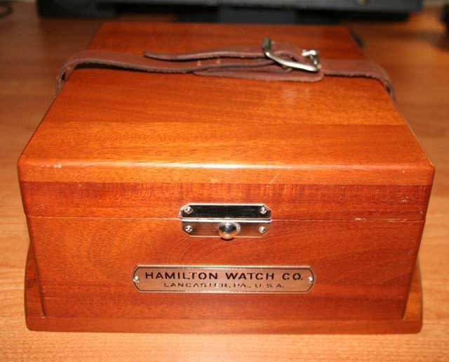

This is the box, closed

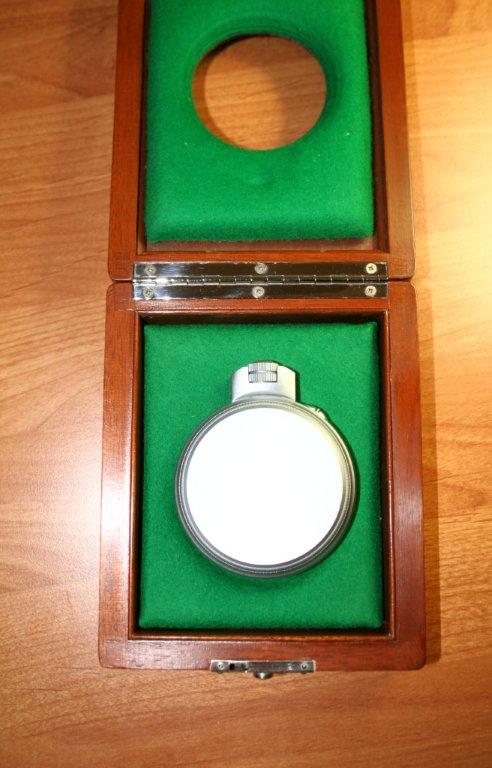

Michael JohnsonThe open box

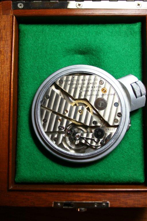

Michael JohnsonMovement, note the serial 2F6227

The one above does not have the card, but it does have the original cloth sleeve that the watch came in (not shown above).
As for your non-engraved 22, does it have the contract engraved on the movement like mine (which is the 1942 contract)?
I'm still up in the air on this one, my gut is leaning towards that an older movement was put into a new case/box, which when I say new was definitely original and from a later movement that was sold after the war.
My gimbaled 22 has the original finish on the box and the finish on this box is the absolute same, it has not been re-done. I've seen Gary's work on these types of boxes and I can tell you that although close, his work does not exactly replicate the original, but is pretty darn close. That leads me to believe that this was one of the post-war boxes/cases which got joined with an older movement.
What I think is interesting is that the older movement is right in middle of the second run that was delivered to the Navy, so I'm having a hard time believing that it was surplus in some way.

Werner Rosierquote:
Hi Michael, is that rearly the contract No.?
I´m throwing this question in because I have never seen a movement without a date and U.S. Navy-BU. Ships on it. I´d like to believe that Hamilton used up all the previously made movements (WW2) and cased them in newly made and non engraved cases.
I´ve been wrong before and I may be wrong again here but, I´d be glad to see a picture of one without the engravings though!

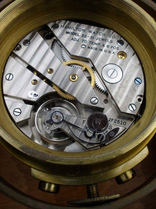

I did run across this picture, which is a gimbaled 22 without the US Navy Bureau .... engraving on the movement.
At this time, I'm just going to go with it, I can't prove one way or another, so I'm going to take it at face value
