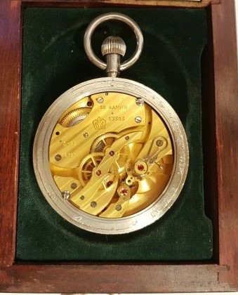

Hi all,
I just purchased my first Poljot Deck watch and as usual it has a problem. When I say as usual I meant for me as I tend to fix broken watches and bring them back to life,
The above watch has a broken staff and I was wondering if anyone has one or knows where I can pick one up. I know they are on ebay but the price seems a bit high so I thought I'd look around to see if they are out there first.
I don't have it yet so not sure if it needs any thing else but will wait and so.
The picture is mine but and it shows the balance out.
Many thanks
Gary

It looks like the balance wheel is missing ?

Kevin,
It is not shown in this picture but it does come with the watch.
I have a series of pictures the show it.
I just put this picture up to show what I purchased.

Jim, Kevin,
Just to let you know I have sourced a new staff and it is on the way as well as the watch.
I believe it is sitting at my local post office waiting for me to pick it up.
I wll post more when both the watch and staff arrive.

Hi All,
Just and update, I received the staff and the watch as well.
A side note is that the staff is not a friction fit but its a riveted fit so I have passed it on to my good friend to fit the staff and roller table and hair spring.(my staking set won't allow the roller table to fit in the largest hole and its not an inverto style so off ot someone with more experience).

December update,
Staff fitted into balance but just before about to intstall balance, checked the jewels, one cracked so now on the lookout for lowere balance jewel.

Happy New Year Everyone,
Well its finaly finished and running strong.
Many Thanks to a good friend of mine that helped me get this lovely watch running again.
