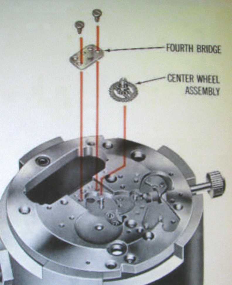

Chris Abellhere is a picture of the trouble maker
you have to remove way to much stuff to get to it, tighten, rebuild it all test and find you didnt tighten enough
or to much
then go back in and do it all again , or worse still you tighten it and seems fine then a few weeks later it starts slipping again on the customer and you have the embarrassment of a return,The date models are even more twitchy my friend holds them for a month to make sure. They can run great for a few weeks then stop! some of the reasons I avoid them
