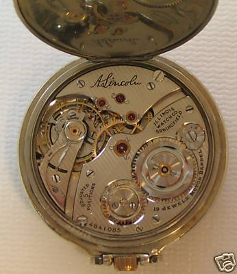

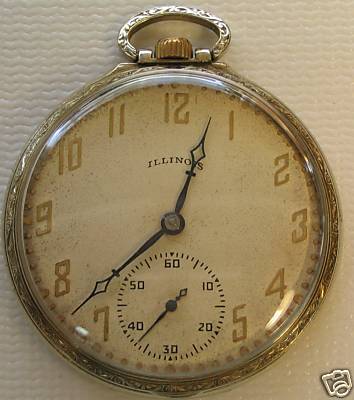

I recently have purchased a pocket watch from an online auction site and would like to learn some information about it. It is a size 12 "A. Lincoln" model (Adjusted 5 positions, motor barrel, stem wound-stem set) in a Gold FIlled Keystone Model #183 Case.
What year was this watch made?

Paul KattnerOops.....
Accidently posted before completing. About how many of these watches were made? The Hinges on the outer back case are broken. It seems to be the watches only problem. Would I need to take this watch to a watchmaker to be fixed or could it be fixed by a jeweler.

David Abbes/n 4841085 (If I see that right) came into being around 1924. Only 12,000 of these were made to this higher 527 Grade which is a extra high quality movement with 5 position adjustment and Jeweled motor barrel (which is where the "extra" 2 Jewels are used).
Our very own member, Leon Harris can look at a case repair for this, and you can reach him at;

Welcome Aboard Paul,
If I am reading the number 4841085 correctly it is listed as 12-size, Pendant-Set, Open-Face, 19-Jewels, Model 3 "Extra-Thin" and Grade 527 which is from late 1926 production.
As noted on the movement it is Adjusted to 5 Positions, these adjustments in addition to Heat, Cold and Isochronism means it is a high quality movement.
My recommendation on the case repairs is to send the watch to a case repair specialist such as our own Leon Harris who comes highly recommended...
CLICK FOR: Need Case Repairs? Call Leon Harris!
Most jewelers would send this work to those who size rings, adding additional expense in addition to the likelihood of an improper repair.
You have a watch that shows some wear but is a worthwhile example.

Robert SchusselPaul
It is estimated that 12,000 movements similar to yours were produced and were classified as Grade 527. An additional 4,500 that were made earlier are listed as grade A Lincoln. They are visually identical.
The plate layout is similar to the Marquis Autocrat which is also considered a thin model.
An ad from 1925 shows the most expensive case and dial going for $132 and the least expensive for $86.00
In the future I would be careful about buying a watch with a broken case hinge as repairs typically cost between $50 and $100.
Your watch is a great addition to a 12 size collection

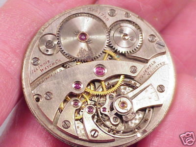

Keith KlimkowiczWe have a data base for these thin model 12size watches.
https://ihc185.infopop.cc/eve/forums/a/tpc/f/8881029912/m/9431014022It features the serial number and production numbers for each of the different jewel counts.
Here is a 19j extra thin model serial #3761788. No case!

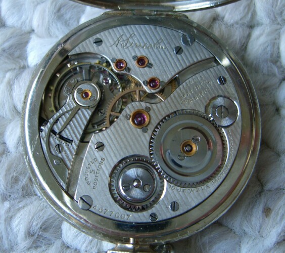

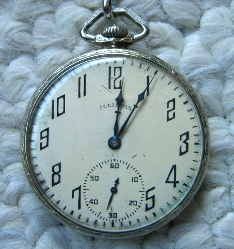

Stephen CarrollHi All - glad to find this site!
I have a watch that belonged to my grandfather that is nearly identical to this watch - the movement is the same (SN 4677007) but the case is silver and measures 44 cm across and is 9 mm thick. If I may, I have several questions:
1. Am I correct that this is a size 12 extra-thin watch? If so, why isn't it listed in the table referenced above (there are no A. Lincoln movements)?
2. How can I identify the case model?
3. This watch has a plastic crystal, but the original was probably glass, correct? If so, are glass crystals still available for the watch?
4. My watch runs fast (+1 min/hr), which seems a bit odd. I see on the movement that it can be adjusted, but it isn't clear to me how to do the adjustment. For example, the watch has the typical adjustment lever, but it seems to be held in place by a pin that moves along the screw below it, and the screw looks like it can only be adjusted by removing the movement from the case - is that true, or have I missed something?
Many thanks in advance!

Stephen CarrollHere is a photo of the movement.

Tom BrownHi Stephen & Welcome to the Club!
I will try to answer your questions but others may correct any wrong info I give or add more.
1. Yes yours is a 12 size extra thin model, yours is a model 3XT grade 527 made in 1925, there were 17 runs made for a total of 14,000. Now these numbers are not exact to give an idea of approx. how many were made. In regards to the table you mentioned that appears to only be a list of model 1.
2. Can you post a photo of the case markings inside the back cover, that might help ID the case model.
3. Glass crystals are still available & our own member William White can custom make you a new glass crystal, you can check out his infor here:
https://ihc185.infopop.cc/eve/f...6013713/m/28710420234. I would suggest that your watch is probably in need of a cleaning rather than trying to adjust the regulator. As the oil drys up the watches tend to start running fast. We also have many qualified watchmakers here that can service the watch.
I hope this helps & again welcome to the club.

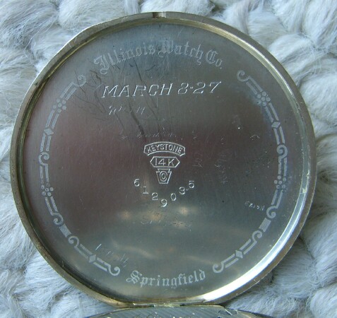

Stephen CarrollThanks Tom!
Here is a photo of the inside back cover - if we ID the case, would that simplfy finding a glass crystal? Also, how should I go about identifying a person to service it?

Tom BrownHi Steve
In the members business directory there are posts of different members that service watches. One that I have used is Chris Abell, you can check out his information here;
https://ihc185.infopop.cc/eve/f...6013713/m/7771058762That is a nice 14K gold case, perhaps someone will be able to tell you the case information. In the mean time, I will do some searching.
Having the model won't help finding the crystal. Mr. White has instructions on how to measure the dial to get a proper fit. If you are going to send the watch out to be repaired some watchmakers can get you a new glass crystal at the same time, I have had Chris put in new crystals for me while he is cleaning the watch, you might touch base with him about that.
