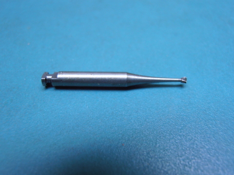

Sometimes when a replacement staff just isn't available it has to be made. Here are some pictures of a recent project. I got so wrapped up in it I neglected to take pictures of the completed staff, but you'll get the idea.
The first picture is a dental burr that I used for the staff. The steel is very high grade and will cut well with the carbide gravers I use.

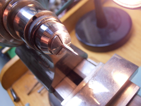

Roger J. NolfeNext is the turning of the burr to begin the process.
January 12, 2014, 13:28

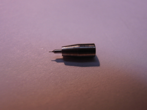

Roger J. NolfeContinuing to shape the staff

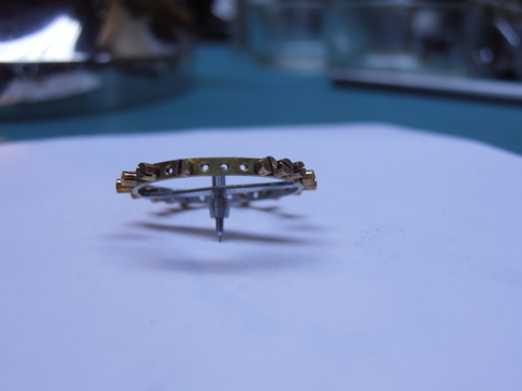

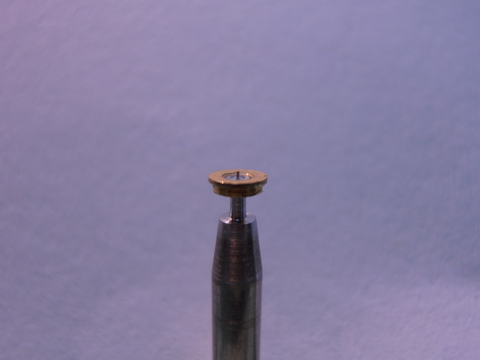

Roger J. NolfeHere is a picture of the balance jewel. The pivot is sized for the jewel.
January 12, 2014, 13:30

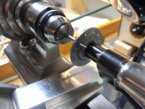

Roger J. NolfeThe shoulder for the rivet must be a friction fit in the balance wheel hole.
January 12, 2014, 13:31

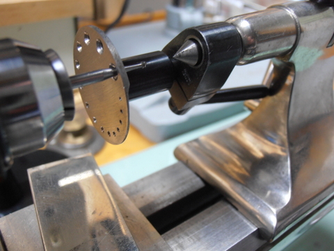

Roger J. NolfeAnother view
January 12, 2014, 13:37
Roger J. NolfeThe other side is made by turning the staff around and chucking it in the appropriate collet and then turning it to the correct size. I thought I had more pictures of the finished staff, but I can't find them and maybe just got so wrapped up in this that I forgot to take them. The owner tells me he'll be posting some pictures of the completed watch. There are at least six measurements that all have to be within .01mm (approx. 4/10,000") to make a good staff.

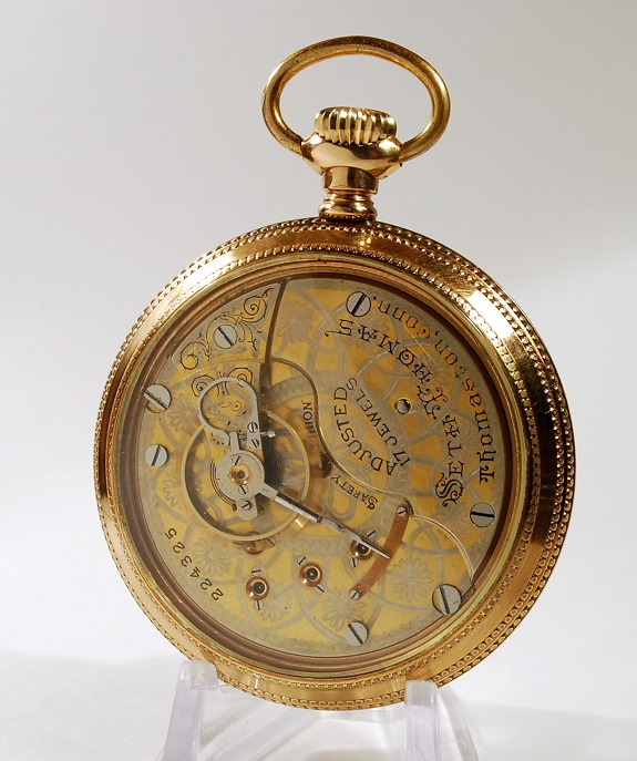

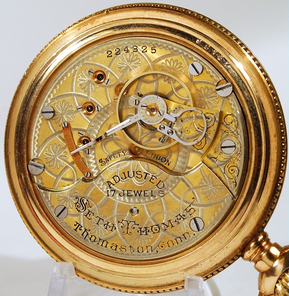

Eric UnseltSomebody once called Roger my "Yonker buddy", and that he is.
I finally found a two-tone Seth that was both a duplicate in my collection and was nice enough to carry. It had a busted staff, and after a couple of weeks trying to find either an NOS staff or a donor Model 5, I wrote to Roger.
January 12, 2014, 18:01
Eric UnseltHe was willing to try fabricating the part from scratch, and you can bet that it probably wasn't easy.
January 12, 2014, 18:04
Eric UnseltBut in the end I knew I'd have a perfectly running watch, and I do - a two-tone Grade 182 Model 5 Seth Thomas that is keeping exact time, and a balance that is running both flat and round.
Thanks, Roger - another triumph!

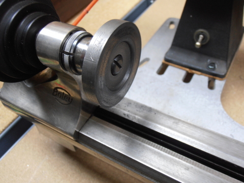

Roger J. NolfePaul,

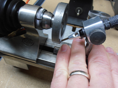

I have a separate Boley lathe setup for sharpening the gravers. They have to be sharpened regularly in order to perform well. The Waller wheel mounted in the lathe is impregnated with a diamond paste that you renew periodically by placing a small amount of paste on the wheel and using a hardened roller to impregnate the wheel. The holder for the graver is a separate tool I think made by K&D. Following are pictures that I hope will help.
January 25, 2014, 10:10
Roger J. NolfeGraver Holder
January 25, 2014, 10:11
Roger J. NolfeHolder placed in groove on lathe bed and graver brought into contact with diamond impregnated wheel.

The work should be true when you turn the piece around if your lathe is in proper order. If you have any doubt and want to make sure, you can use a setup like I have pictured to make sure the piece runs true and then move it away to work or leave it in place to do as much as you want and move it when necessary.
March 01, 2014, 17:37
Roger J. NolfeSecond Picture
