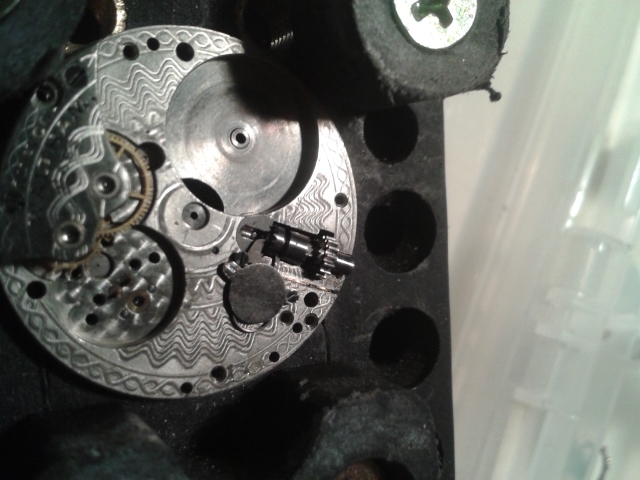

hi everybody, todd here,
i hope i am not being a pain in the butt with all my questions.
i am presently disassembling a Waltham, 1900, size 0. i have gotten as far as the winding mechanism as pictured and stopped. i see there is a spring under the plate with 2 screws just below the winding mechanism. how do i remove this spring without it ceasing to exist except only in my memory. i have been playing with the winding mechanism with my bench key, what an elegant piece of engineering! so impressed.
thanks everyone,
really enjoying being your student.
Todd

Todd Verrierehi Peter,
-my point is this,-
if i remove the plate holding the spring in place, while the spring is under tension, will the spring fly away?
-my question is this,-
do i need to somehow remove tension on that spring before removing the retaining plate, so that when i take the plate off the spring is all cool and relaxed, and just waiting for me to pick it up.rather than taking the plate off and having a spring staring at me all under tension and angry and wanting to disappear the second i touch it.

Samie L. SmithTodd if nothing is broken in the winding parts don,t take it apart, Take the rest of the watch apart but leave that part be ..
, leave the winding parts together and go ahead and run it through the cleaner.. you can lube all the parts of the winding mechanism before you put it back together and it will work fine..
The winding parts and spring on these are a pain to get back together..

Samie L. SmithPeter sometimes i will have to take these apart if they are very dirty or the parts are stuck together with gummy grease or oil ,,if not i leave them be and go ahead run them through the cleaner.

Todd Verrierehi guys,
i am not taking the watch apart simply to clean it. i want to learn how it all works and how to disassemble and reassemble every part of it. leaving something in place would defeat this purpose so i am going to go ahead and take it apart and hope that spring doesn't fly away.
wish me luck.
Todd

Rob CarterTodd,
If you want to take the round plate off just unscrew the plate screw while placing a piece of pegwood with the other hand on the tail end of the spring to keep it from taking off. Lay the pegwood flat across the spring to keep it in place. Sometimes the V shaped springs don't move, but it is better to be safe with them as they can and will travel.

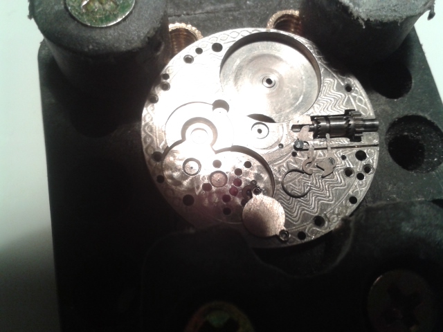

Todd Verrierewell, that disassembly went a little sideways. i held the spring down with a piece of pegwood as per Robs advice and removed the 2 screws from the plate, removed the plate while keeping the pegwood in place holding the spring down. and the shipper lever flew away. although the shipper is held in place with a screw the shipper lever is not. but i found it! 2 feet away on the corner of my bench. i have now reassembled and disassembled the shipper assembly 5 times and have learned the safest way to take this apart is to simply hold the spring down with a piece of pegwood and pull it out from under the plate with tweezers. no risk of anything taking flight and when you remove the plate nothing is under tension.

David E. Booth, Jr.It's a little late now, but when I take those apart, I stick a glop of Rodico over the whole shebang, and just leave the screw(s) exposed. I back the screws out, then carefully lift the Rodico with the spring embedded in it. Those who advise not taking it apart have more faith in their cleaner getting into (and getting the solution back out of) small places than I have.
I have had a lot of excitement, and befouled the air with my language - (since I am alone, I can, and will drop the F-bomb at appropriate moments)while reassembling those gadgets. Dave's tutorial is as good a method as any I have tried for putting the durned spring back. Incidentally, if you look at the spring with a strong enough lens, you will see that (a) it is not a wire; it is a flat spring, and (b) sometimes the ends are not cut perfectly normal (at 90 degrees) to the length. I just reassembled a size 12 grade 220 today that took me three tries, because the ends of the spring were cut at a slight angle, and I had to get the spring right side up before it would stay put while I set the cap in place and started the screw.
