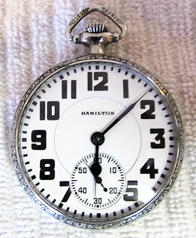

My first purchase is a Hamilton 992 #2482872 with a Star Nickel case #8084833.
I have a few questions I hope you can answer.
1- Is this case period correct for my movement? I can't find much about Star cases and I am unclear as to if this movement could have been sold with or without the case.
2- What would be a period correct case from Hamilton? If I understand my research correctly a Model 3 through Model 10 case could be used. I actually love this case and if it is period correct I will leave it alone.
3- Are the hands and dial correct for the movement?
4- Finally, Feel free to critique any issues that you see.

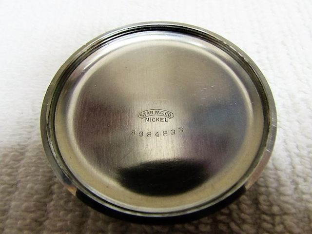

Rear case

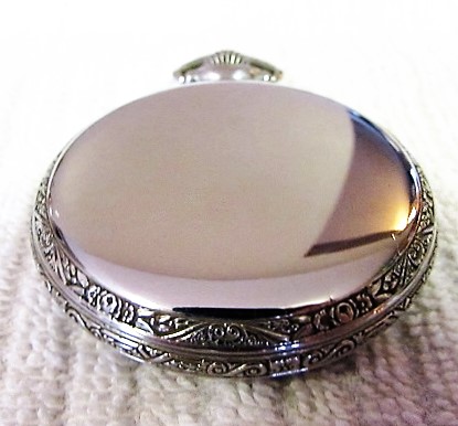

Inside back case

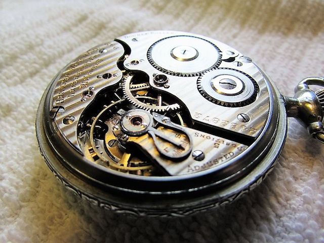

Movement

Hello Brad,
Rarely can a fella go wrong with a 992 or 992B pocket watch. Would venture to say your movement has been re-cased into the current nickel case. The movement most likely came in a Gold Filled (possibly a Model #2 (BOC)) case that lasted for so many years and the gold wore off from normal use. The Star case is a good carry case and easy on the eyes.
The hands, dial, and movement look period correct.

Hamilton 992 movements could be bought as "movement only" up until 1929 when Hamilton started offering their 992 movements as "factory cased" only. Your Star nickel case with its low pendant would be a period correct case for a Hamilton 992 such as yours made in 1927-1928.
A "factory case" for your 992 would/could have been a Model 1 Cross-Bar Wadsworth, Model 2 Wadsworth, Model 3 Fahy's, Model 4 Fahy's, or a Model 5 Keystone. These cases were made in white, yellow, and green gold filled for the most part with a few being solid gold also. Factory cases made after the Model 5 Keystone would be too late to be period correct for your 1927-1928 Hamilton 992.
Dials for the 1927-1928 Hamilton 992 would be a porcelain DSD styled in heavy gothic #519 [such as yours], heavy arabic #436, heavy arabic numerical #581, C.P.R. #577, numerical, or blind man #576, blind man numerical #522.
We generally do not recommend using any of the on-line "data-bases" for Hamilton as they are chock full of errors. Instead with Hamilton please always use our IHC185 data-base by John F. Gelson;

Your watch appears to be a nice example of the Hamilton 992. The Star case once held an Elgin looking at the other set of case screw marks. This is not unusual for a watch made almost 90 years ago.
Always wind your watches fully when in use and after they have undergone a "C.O.A." [COA- clean/oil/adjust] by a good repairman.
