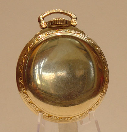

Attached are pictures of a reciently acquired 992 B. The watch seems original, complete and is very clean except for a deep gouge in the inside of the case back and light scratches on the out side of the case back and one spot on the winding wheel. The serial number is C1006 dating it I think to the end of 1940 or beginning of 1941. I have requested a serial number look up. I think it has a gold center wheel and gold jewel settings. I would appreciate comments on the dial hands etc. Bob Rork

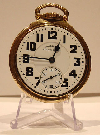

Robert Rork
Dial details

Robert M. Sweet
Bob,
Below are three links that may give you some insight on the 992B hands and dial.

Welcome to Chapter 185 Robert! Nice early 992B, everything about it looks right as rain IMHO. Being from very early production it has what we call a Signature Type 1 movement.

Robert Rork
back of watch

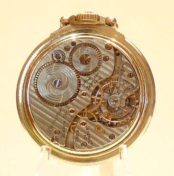

Robert Rork
movement

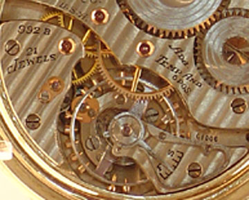

Robert Rork
oops 4 pictures movement detail

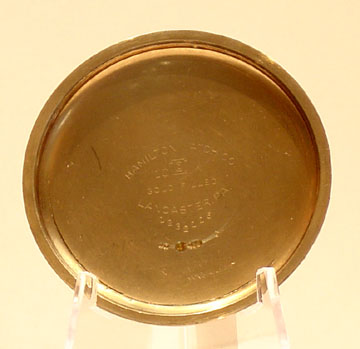

Robert Rork
detail of case sig

Jim Hanie
BOB,
A VERY FINE 992B EXAMPLE. AN EARLY 4 DIGIT SERIAL NUMBER IS A GREAT WATCH TO HAVE IN YOUR COLLECTION.
NOT MUCH TO COMMENT ON ABOUT THE DIAL AND HANDS OTHER THAN TO SAY THEY ARE CORRECT AND IN FINE CONDITION.

THE EASIEST AND CHEAPEST WAY TO IMPROVE YOUR IMAGES WOULD BE TO BUILD A LIGHT BOX. THIS WILL BRING OUT THE DETAIL. THE LIGHT IS SO BRIGHT IN YOUR PHOTOS THAT IT DOESN'T SHOW THE FINE DETAIL THAT YOU WOULD SEE IF THE LIGHT WAS FILTERED. YOU WOULD BE ABLE TO SEE THE GOLD CENTER WHEEL IN MUCH CLEARER DETAIL IF THE LIGHT WAS FILTERED DOWN.

I notice that this watch does not appear to have the period-correct beveled ratchet wheel screw. My guess is that a previous screw, perhaps an incorrect one, was what caused the gouge in the back cover. Someone probably replaced it with a later flat-profile screw so that it would not bind with the back. If you try to find a correct replacement be careful that it does not jam the back again.

Jerry thanks there are actually two marks on the back. One light mark near where the case back turns up to form the thread and the other just below the the serial number. Some sort of screw problem must be the answer but if you examin the deep gouge it looks like someone left a crown wheel turned on edge and then pressed the back on and tried to turn it. The main damage looks like it was caused by something with teeth like the edge of the crown wheel. There are not service marks on the case back which makes me wonder if it was used for railroad service. Maybe a railroader bought then went off to war? That might explain how a less skilled or careful repair person caused the damage. I will look into the correct screw. Bob

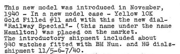

Robert M. Sweet
Bob,
Thank you very much. The "Sold to" numbers are unknown at this time.
No records, to my knowledge, have been found that links these numbers to a specific customer.
Your ledger page lists eight 992B "sold" on Nov. 5, 1940.
It appears the eight 992B's sold on 11-5-40 could very well be part of the initial shipment of 940 watches made on November, 5-6-7, 1940, as shown on the "excerpt" below.
(If we can conclude that the watches "sold" on these 3 specific days are indeed part of the 940 shipment, we can then link these serial numbers to the #11 Hamilton case.)
The "excerpt" below is from the Hamilton Watch Movement History.
Robert
Courtesy Don

Robert it is also interesting to note that all but 1 of the "940" (?) shipment went to one customer. Bob

Robert M. Sweet
Bob,
I assume you are talking about the 8 watches listed on your ledger page and not the entire 940 watch shipment.
I counted 6 watches going to customer 74-68225 and 2 watches going to customer 51-68206.
