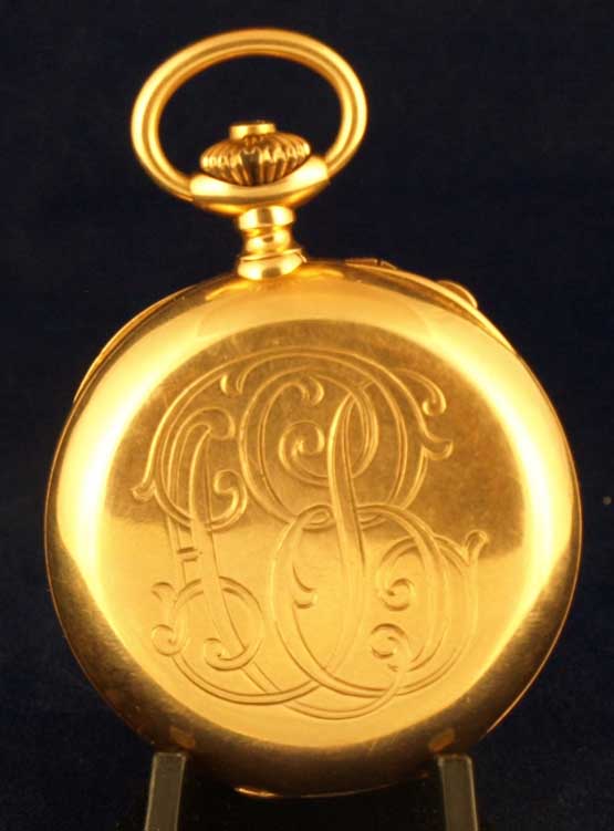

The second watch she inherited was a Patek Philippe pocket watch.
It's 23 jewels, PW/PS, open face. The dial has a seconds chapter at the 6 o'clock position and there is a second second chapter around the outside of the dial and two sweep second hands. All the hands except the 2nd hand look like they are made of gold. The dial is signed Spaulding & Co. Chicago.
The back of the watch is engraved with the initials AEB. Inside the top cover there is a 0.750 mark to show it's solid 18K gold. The couvette is engraved around the edge. At the top is:
Spaulding and Co Chicago
At the bottom:
Nov. 17th No. 90040 1903
The movement is marked:
Patek, Philippe & Cie.
Geneva
Swiss
Spaulding & Co.
Chicago
It also shows the serial number 90040 which my book says is 1895-1900.
This is the case back:

posted May 11, 2010 18:49
If I try to wind the pendant, the watch will run. The spring won't wind, but the movement runs.
Any info as to exactly what this would be called or any other info is appreciated.

Very interesting split seconds chronograph. Perhaps the mainspring is already fully wound? Does the watch run on its own or will it only run when you turn the pendant?
RR
Posts: 1413 | Location: Fremont, California in the USA | Registered: February 06, 2010
posted May 13, 2010 14:27
Only when turn the pendant. Your comment made me think and I went to see if I could see the winding mechanism. Unfortunately, it's hidden under the top plate. I don't see any way to let the mainspring down.
I've been told that the best way to have this fixed is to send it to Patek, Philippe. Has anyone ever sent a watch to them?

You may want to contact Chris Abell first. He's listed here in the IHC185™ Members Business Directory. Here's an interesing topic and you can click on his link and go right to his website. Size 12 Tiffany needs balance
