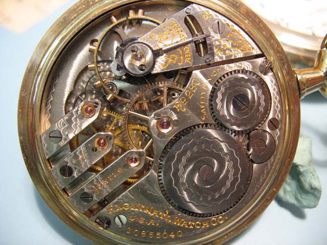

The Elgin 280 was a purpose-made RR grade 17 Jewel movement produced in small quantities during 1902-03. Due to the Low Jewel count and the period of manufacture, Elgin only finished about 8,000 of these with some movements not signed at all, some signed B W Raymond, and some signed "280".
That said, these were all made at a time when the only balance springs were steel, thus requiring bi-metallic cut wheels for temperature compensation.
You must (hopefully) have one that was later "converted" by a watchmaker or Elgin to use the 30's vintage higher grade Elinvar Balance spring and uncut wheel.
A picture would help a lot. For reference, I add a movement picture below of one of my 280's (s/n10855040) that came from the last run of these fine timepieces and shows the original Blue steel Balance spring and cut bi-metallic wheel.

Very sharp watch, Dave. The gold lettering really sets off the movement.

David, Wonderful Watch! Just look at that beauty!
Makes me drool...............
