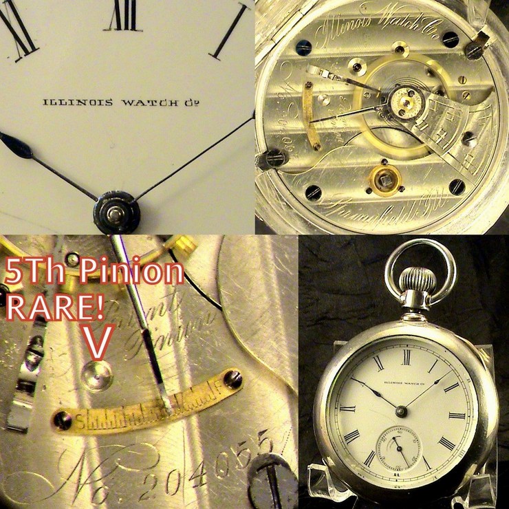

Walter, your Grade 99 is SUPPOSED to be a 5th pinion transitional Key wind movement that is actually made to be lever setting and pendant wound. I had a few of these go through my collection and they all looked sort of like the one below. If yours is actually in a hidden key case, the case is actually worth about ($300.00-$400.00) three times the movement and the movement should be switched to a "normal" Pendant wind lever set OF case.

Thanks David, as that was what I suspicion-ed when I suggested that pictures be added to make certain.
Saving all the pictures that you have over the years David and then posting them when questions arise is very helpful. I for one appreciate that you have saved them and that you post them, and of course your always spot on helpful information so Thanks !!

Thanks fellows, the watch is the same as the one Dave showed. I guess I will move it up the line and do some tinkering. Always a pleasure to have you share your thoughts and expertise. Thanks again.
