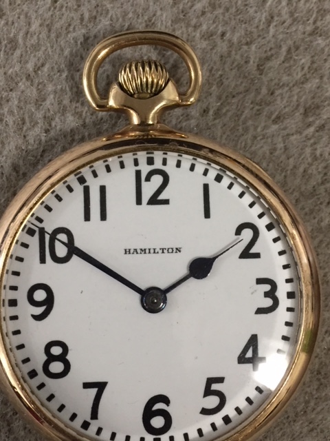

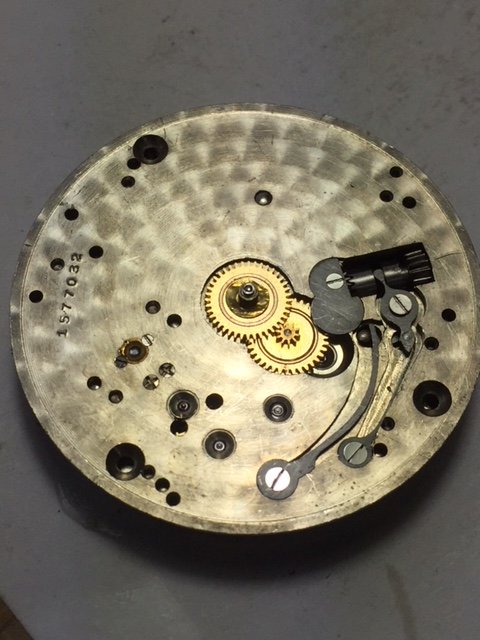

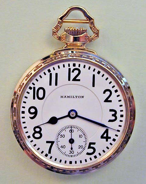

This dial fronts a 975 Hamilton 17 jewel Hunter configuration in a triple hinged C.W.C.Co. case in pretty good condition.
- movement serial # 1577032 circa 1924
Is this dial genuine, period correct or a reproduction. Iv'e had this watch for about 8 years and and am just now getting around to asking about the dial.
Any input would be appreciated.
November 06, 2017, 12:00
Buster BeckRick it's obviously a "conversion" dial without a seconds bit to use a hunter movement in an open face case. A lot of watch companies made conversion dials usually to move hunter movements that were overstocked in their inventory to go in open face cases which were becoming more popular.
 What material is it made of ? Have you had the dial off ?
 It appears to be period correct for the movement from 1924 that it is on.

Buster BeckThank you Rick. Probably having a look at the back side of this dial would give us a better idea of whether it was made after Hamilton closed or not.
 I lean toward aftermarket, but I can't be positive without seeing the back. A lot of aftermarket dials I have seen had the same slightly "off white tint" to them which yours appears to have.
November 07, 2017, 09:19
Kevin HoffmanI had to look twice at that one , the 6 is bolder and darker , I would love to see the back also . Harry do you think your dial is by hamilton ?
November 07, 2017, 10:08

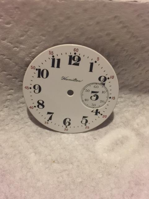

Clark ReedI am surmising.... that the reason the 6 is bolder and darker is because the CPR D/S dial shown here does have the seconds bit and perhaps the maker of this dial somehow copied it and then had to add the 6 because the CPR dial does not have a 6....

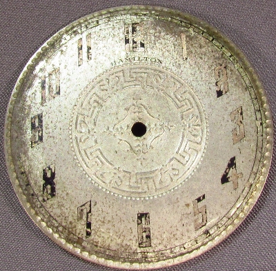

Harry J. Hyaduck Sr.Kevin I believe it to be an original dial but I have no way of knowing. I bought the watch a long time ago for if my memory serves me right about $26. The seller thought it odd that it did not have a seconds chapter which peaked my interest. I have a post on it
https://ihc185.infopop.cc/eve/f...703955667#9703955667 The dial was redone by International Dial Co.

Harry J. Hyaduck Sr.Kevin The 6 does look a little bolder to me also. Also if you look at the shadow on all the rest of the numbers the shadow is to the right and below the numbers. If you look at the 6 the shadow is above and to the left of the number. The International Dial Company told me they had about 1000 original Hamilton dial patterns and this is the way the finished it. I don't know if the 6 was added on or if the original template was that way. Here is what the original dial looked like.

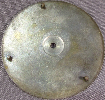

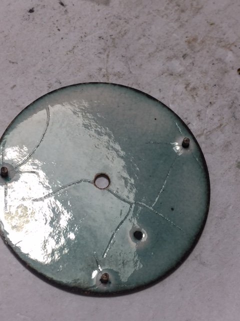

Harry J. Hyaduck Sr.Mike here is the back of the dial. I have heard Lindell's theory from other sources and it does make since. Mine is marked "Made in the USA" also and one theory was that it was an overseas version and was converted for overseas as a lot of movements overseas do not have a seconds hand.

Tim PooveyGreat photo of the dial Rick, might be my eyes but to me the "6" looks off center. It looks closer to the 29 min mark. It just doesn't look like something Hamilton would have done.
Does anyone else see it that way?
Tim
November 07, 2017, 20:01
Harry J. Hyaduck Sr.Tim it looks centered to me although if you look at the space between the 6 and the 5 and the 6 and the 7 it appears closer to the 5. I believe it looks that way because of the shape of the numbers.
November 07, 2017, 20:21
Tim PooveyI noticed that also Harry, but when I look at the bottom of the "6" the distance between the 29 min mark and the 31 min mark appears different.
Something just doesn't look right!
Tim

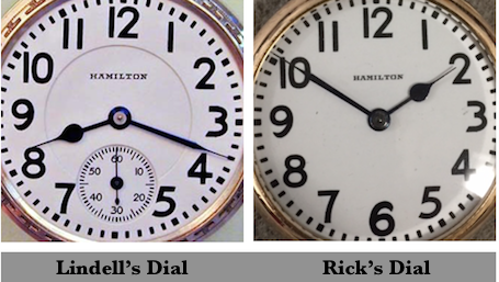

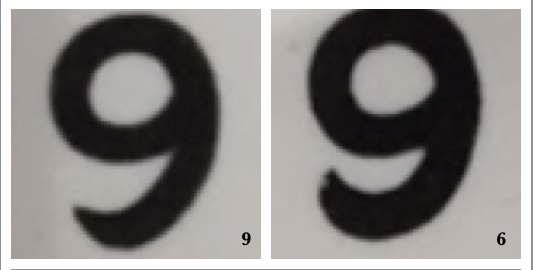

Lorne WasylishenThis is a shot of the 9 and rotated 6 on Rick's dial
November 08, 2017, 01:29
Lorne WasylishenSide by side of Lindell's dial and Rick's dial.
Here's a spitball theory. Hamilton took uncut dials and stamped the 6 on them to provide conversion dials in order to sell hunter movements that were no longer in favour.
I admit they could have done a better job on the 6.
There are a few quirks about these dials that are similar.
The top of the 2 in the 12 looks a little fat.
The top of the 2 reaches to the left.
The 1 in the 10 looks slightly taller than the 0

On the WHITE DIAL we have Clark Reed and I both surmising it is a recently created dial.  I posted... "My thinking is the dial in question may turn out to be contrived using computer-generated scan of a Hamilton C.P.R. or "Canadian Pacific Railway" style number 577 dial with an inverted (upside-down) "9" inserted as a "6" to replace the seconds register when the dial in question was printed.
Seeing the back
 of Rick's dial could prove very interesting."
And then Clark apparently agreed, with... "I am surmising.... that the reason the 6 is bolder and darker is because the CPR D/S dial shown here does have the seconds bit and perhaps the maker of this dial somehow copied it and then had to add the 6 because the CPR dial does not have a 6...."
OH YES, and that is why I posted the Original Hamilton C.P.R. Dial which also appears here...
https://ihc185.infopop.cc/eve/f...?r=39510695#39510695
REMEMBER we have now seen the back of Harry's refinished METAL DIAL which was redone in a slightly different pattern (it now has "shadowed" numbers which it did not have prior to the recent refinishing, so compare Harry's "before and after" images carefully.) and we know it was once the practice with metal dials to include dial refinishing as part of the watchmaker's servicing of a metal-dialed wrist or pocket watch.
In my opinion Harry's METAL DIAL is one of those sold to jewelers by after-market suppliers back in the 1920s and through the Depression Era. (Similar methods are used to make some of the counterfeit dials today.) Unfortunately, there is no way to determine the number of times a METAL DIAL may have been refinished.
Refinishing a dial alters it so that originality is forever gone.  For that reason surviving watches with top condition original, not refinished metal dials command a premium with collectors.  One more point, the metal dials when original, usually have markings on the back, those are usually obliterated as part of the refinishing process.
Back to the WHITE DIAL which some of us view with suspicion, Lorne posted an interesting comparison while I was typing and Lorne's comparisons, particularly the 9 versus 6 mockup are very interesting!  (But I must respectfully disagree that Hamilton would have sold such a sloppy-looking dial as the WHITE DIAL in question.) Leading me to again show a 640X480 of the Genuine 1924 C.P.R. dial from my collection which has completely uniform, perfectly matched numerals posted long ago here...
And shown again below, study this carefully...

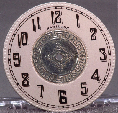

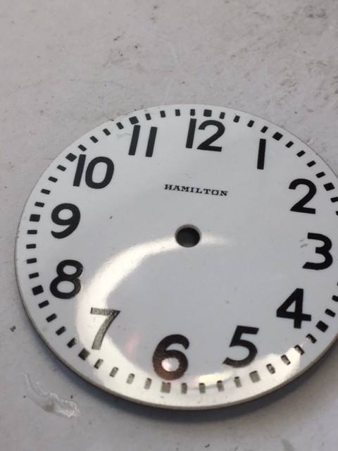

Gary E. CochranThis is a conversion dial I have in a drawer...I tried to sell it on the group a while back but noone was interested so I thought I just keep it ...Interesting conversation piece...What do you think about this one...Factory Dial???Looks like it might be to me but I am surely no expert..
November 08, 2017, 20:34
Gary E. CochranPic 2
November 08, 2017, 22:03
Roger StephensLooks like the real deal to me!
Roger
November 09, 2017, 09:34
Buster BeckI agree with Roger. The few porcelain conversion dials Hamilton made that I have seen had the porcelain on the back side also. Nice dial Gary !
November 09, 2017, 12:18
Gary E. CochranThanks Buster and Roger...I was thinking this was a factory dial, but was looking for someone with a little more knowledge than myself to confirm...Thanks again, Gary

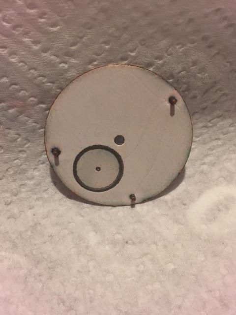

Rick FarmerHello, here are a couple of photos of the back of the dial. The back of the dial is glazed.
also a shot of the dial and watch back plate.
Rick

Mike BendaThanks Rick, originator of this interesting discussion.
What are we seeing here seems to have come from the factory, in my ignorant opinion.

Bila WirriganwaltersI am still a bit skeptical with regard it coming from the Hamilton Factory, a Factory yes but maybe a Swiss based one (glass repo dial????) or maybe a re-fired dial to get rid of the subdial, as that 6 is definitely odd, which everyone has alluded to.
I would like to see that dial back in much better light and at different angles to see the glass enameling better.
