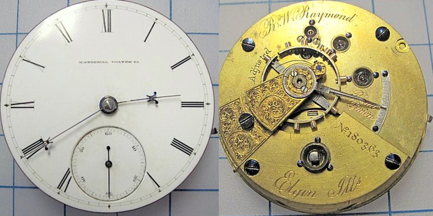

Ken Knight recently posted an early Elgin movement he acquired with some questions;
https://ihc185.infopop.cc/eve/f...86047761/m/437101703
After looking into it and replying to Kens post with a "first guess", Ken contacted me and we reached an agreement by which I could acquire this item.
Researching it further in the Elgin Site which only requires adding "v=7" after the serial number which in this case would look like; "180363 v=7" brought three interesting points;
1. Grade 69, 29154 total made key wind model 1, 15j U-A Marked BWR or None. gilded
2.notes on grade 69: Marked: BWR or None. first 18s grade
first HC style first key setting first 15 jewel
3.# SN322182 seen as "BWR 15j Adjusted REG_ELGIN" with an Abbott's conversion on ebay 1693600817
865001 marked "None" according to 1896 MC
So The factory data is these are ALL Key Wind Key Setting, BUT 1 of the Elgin detailed references is reported to have an Abbott's Stem wind conversion.
To Learn more about what this is all about, go to "Abbott's Stem Wind" which is the very first manufacturer listed in the watch guide (Pg 104 of 2010 issue).
As an adjusted 15J, (Abbott Conversion) Lever set, it could also be RR Grade at that time!

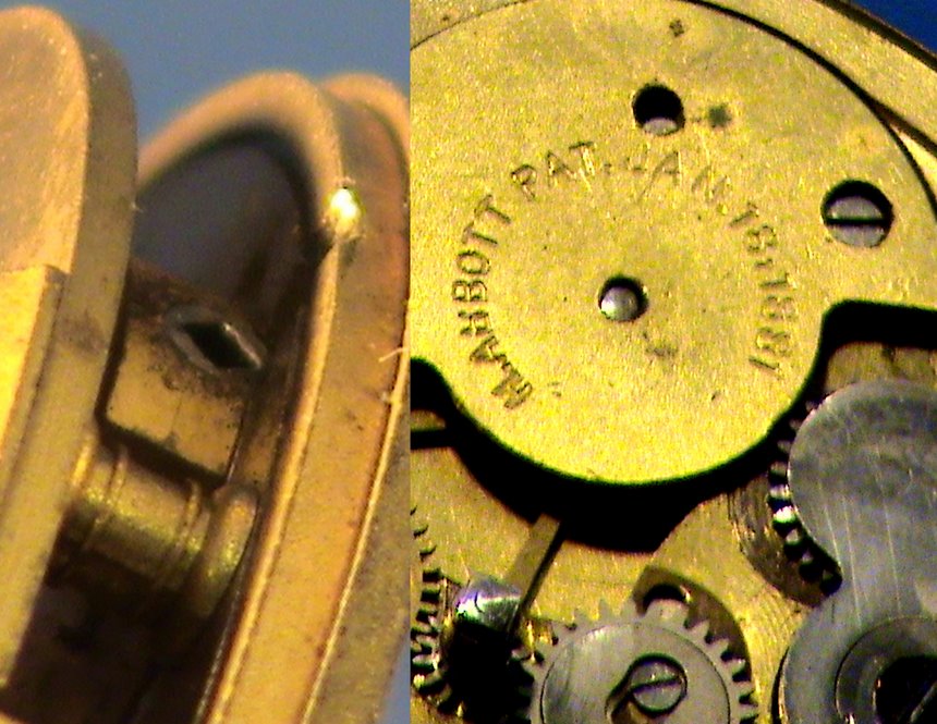

This is certainly an "Abbott Stem wind conversion!

Here is how it works, and note the setting gear that engages the cannon pinion is on an adjustable journal bearing plate to acommodate the different movements this was used on.

The stem winding part is actually recessed 4mm (almost 3/16) from the dial plate rim. As this was most likely in a Gold Case, I have to find an early Coin SIlver Stem winding Hunter case that might agree with it. The hard part is the setting lever is very near the winding pinion.

Think of it! This is a 1871-3 production period Key Wind and Setting Elgin movement with an Abbott Stem wind conversion signed with the 1881 patent. The price guide says "Abbott sold over 50,000 wind attachments . . . fitted to" at least 10 different watch maker's movements, including Elgin. So . . . when was this one re-fitted? It had to be after 1881!
