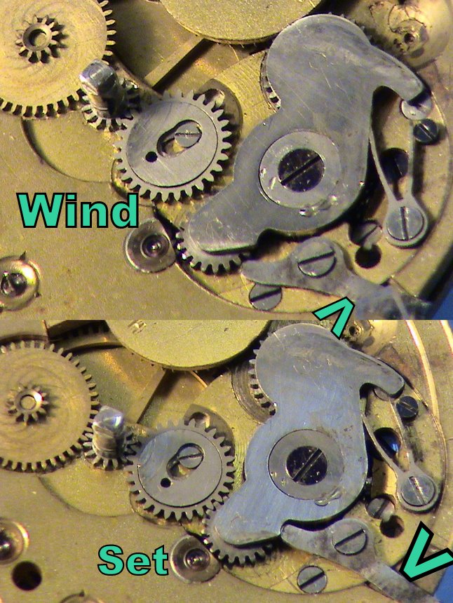

Here is how it works, and note the setting gear that engages the cannon pinion is on an adjustable journal bearing plate to acommodate the different movements this was used on.

The stem winding part is actually recessed 4mm (almost 3/16) from the dial plate rim. As this was most likely in a Gold Case, I have to find an early Coin SIlver Stem winding Hunter case that might agree with it. The hard part is the setting lever is very near the winding pinion.
