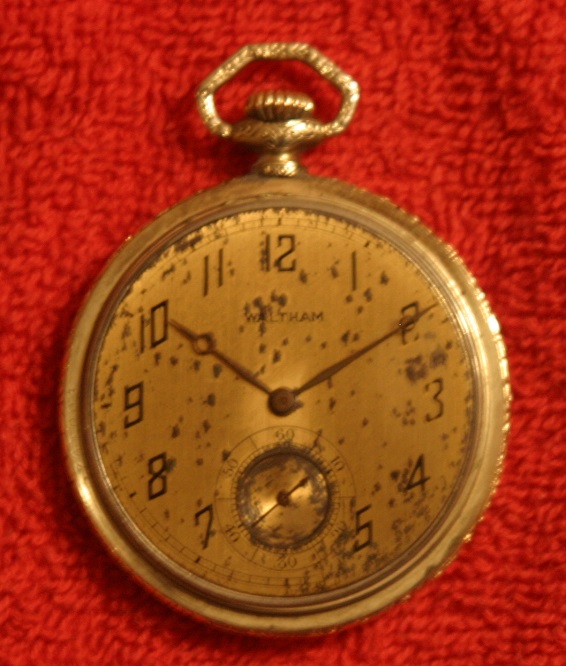

Hi,
I want to restore my great grandfathers pocket watch. It's a 12s Waltham model 1894, serial # 24102439 with a gold tone metal dial and moon hands. The plastic crystal turned yellow and has eaten away at the dial and hands. It isn't running either but it winds and the hands set.
This is my first attempt at making any repairs. I bought screwdrivers, tweezers, a movement holder, oilers, hand pullers (presto # 1,2,3,6). I'm working on finding other tools, hint, hint, if anyone has what a beginner would need.
I would like to restore it to look as close to original as possible. I've been looking on ebay for a dial but I'm not having any success. This is what the dial and hands should look like.
http://www.thepocketwatchguy.c...fill-case-circa-1921
I removed the crystal and dial. The dial feet are at approx. 18,35.5 and 56. I haven't removed much else yet. Still reading and watching videos. Can someone please tell me other sources where I might be able to find a crystal, metal gold tone dial, moon hands and possibly a mianspring for this watch other than ebay. Any help would be greatly appreciated.

As the others have mentioned I would not even attempt to anything on your grandfathers watch have that restored professionally and sympathetically to maintain as much of the original watch as possible, all to easy to destroy, and concentrate on scrap watches to learn a little on you will soon find out how easy it is to damage them. A dial refinish can run $50- $200+ it all depends who you send it to and if they have the screens, it will look odd new fresh paint on a old watch no longer be your grandfathers dial, and expect blurry and often misaligned stampings when compared to original can you post a picture of the dial to give us a idea, we are assuming it’s a dial that can be refinished.

posted
Email it to me, Richard. I'll resize it for you.
If you'd like those hands re-blued drop me a note.
Richard's watch:
Posts: 2962 | Location: Western New York in the USA | Registered: March 24, 2008
