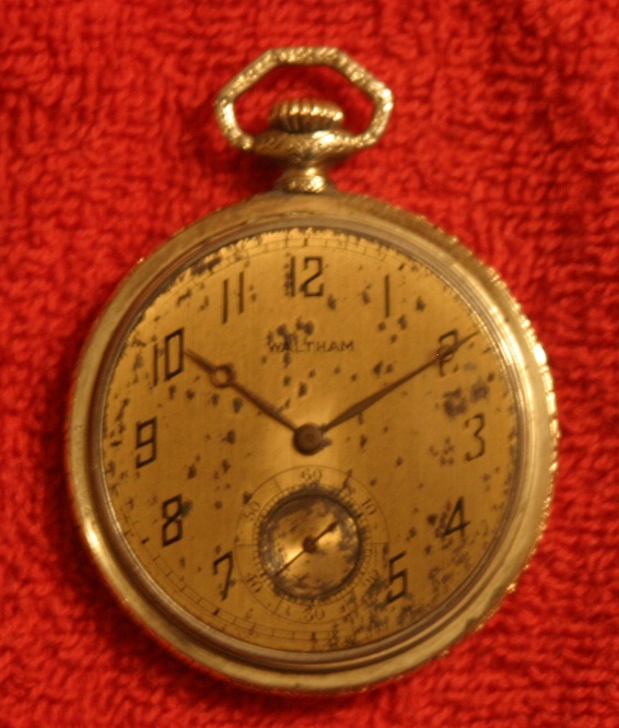

Email it to me, Richard. I'll resize it for you.
If you'd like those hands re-blued drop me a note.
Richard's watch:

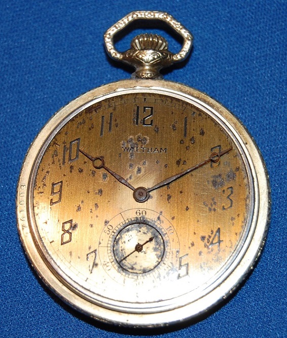

Another picture.

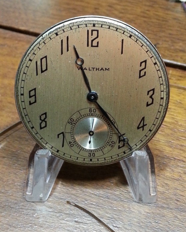

Paul D. Trombley
Rick,
This watch was frustrating me so I tossed it in my parts bin in favor of a 21 Jewel Riverside with a jeweled motor barrel... Which is now on eBay in a solid 14K white gold case...
So, this watch is yours for $20.00 delivered if you think these parts will work for you.
The dial diameter is 1.49"
Take care, Paul

Lou Copas
wow.. the watch Paul has is a great head start on the restoration..
