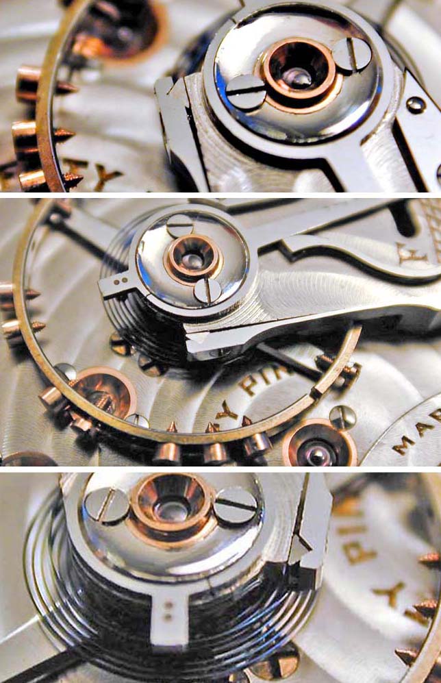

The bad news is the hairspring is missing and the mainspring barrel,,,the plate and mainspring arbor is there and i do have a mainspring barrel that will fit,,,My question has to do with the hairspring and hairspring stud which attaches to the side of the balance cock it looks like it should be a traingle shape is that right and does someone have a picture of the hairspring stud..

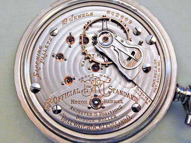

Here you'll see similar watches including one from the same run...
BALL RESEARCH FORUM: "Later Ball-Hamilton 18-size Images"
From those you can see when a change in design took place.
I'll take close-ups of number 642669 to hopefully be of help.
July 09, 2007, 20:39
Triangular hairspring stud details, three angles merged...

Samie L. Smith
Lindell That's great what a help the pictures are nothing beats a picture, this tells me what I need to know, this is one of the things that make Chapter 185 so great is all the things folks do to help one another. Smile
