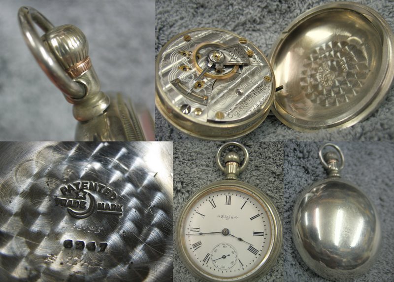

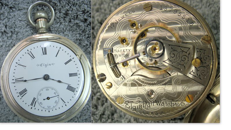

Thanks for trying it Ed, I thought it was time to go into more detail, expecially with Mary Ann goin to school and all. This is the Elgin "all dressed"!
IHC Life Member
Picture of David Abbe
posted
This has been waiting over 100 years to "ham it up"! What a nice running, clean and pretty "Ham" it still is!
