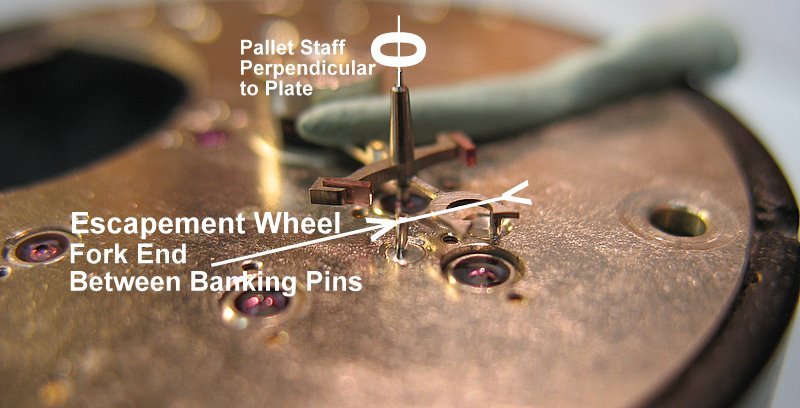

The single most valuable "tool" I use Rodico for is to make final assembly of full plate movements much easier. I use a small "string" of Rodico to hold the "short end" of the Pallet into it's top plate pivot . . .

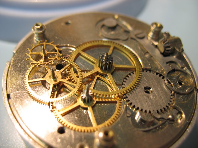

Then I can assemble the whole train to the Pillar Plate . . .

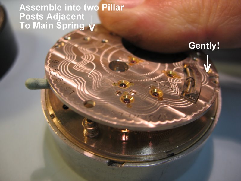

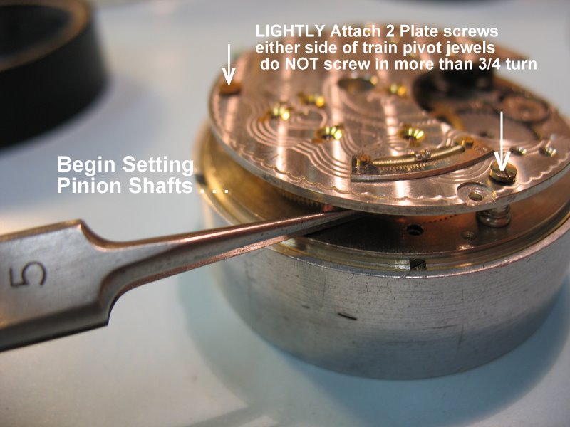

Then put the top plate carefully down bringing it into registration with the pillar plate by engaging the two pillars adjacent to the Motor Barrel area. That way I can gently "rock the plate down so ALL of the pinions are close to their pivots . . .
April 19, 2009, 17:24
Then I insert the two Pillar Plate screws either side of the train pivots and screw them in less than 1 turn to keep plate registration, gently pull out the Rodico string and reach in with my "#5's" to begin setting the pinions . . .

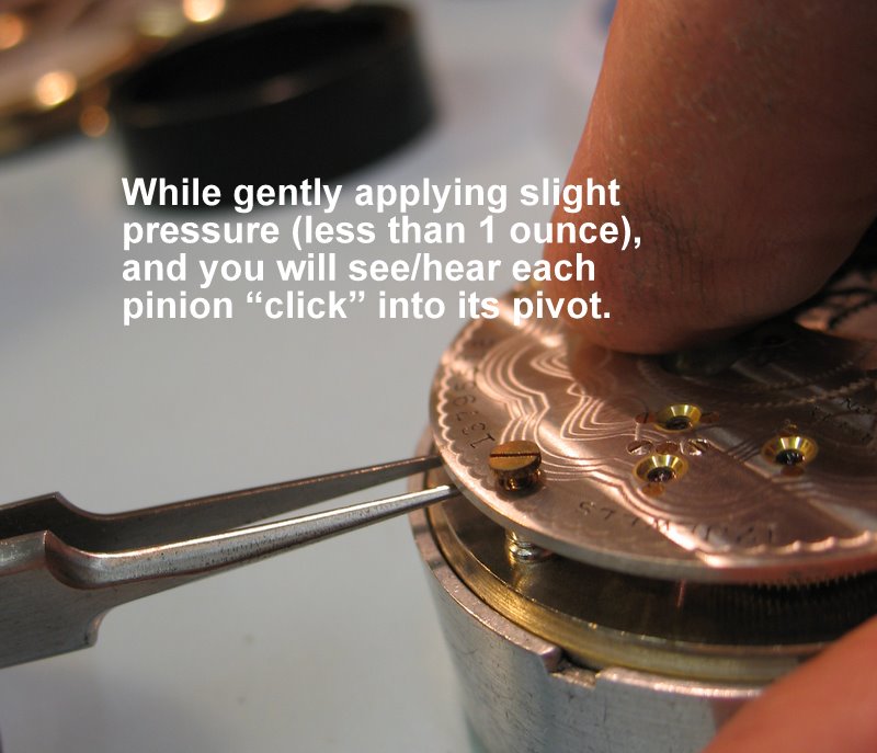

While applying very light (less than 1 ounce) pressure to the top plate . . .

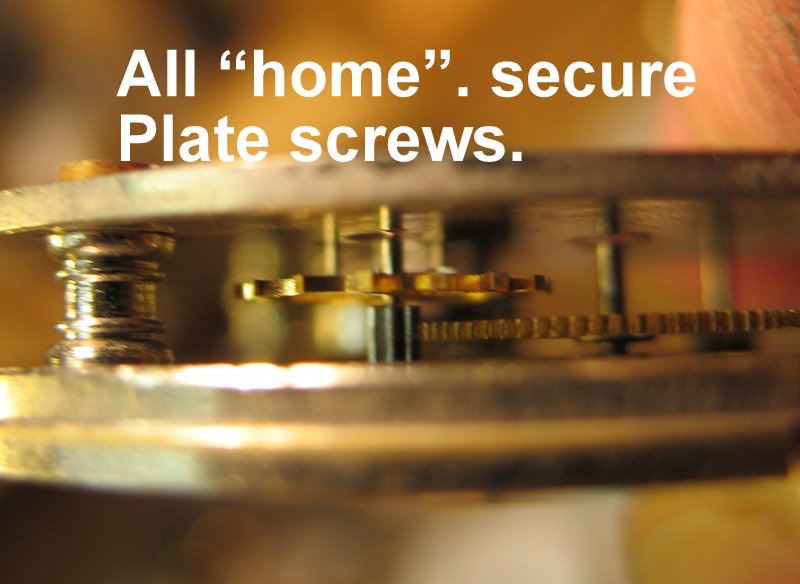

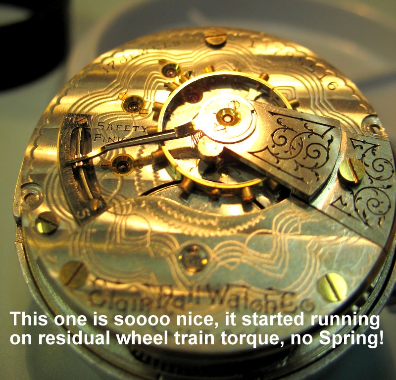

When all Wheels and the Pallet Fork are in place, I carefully screw the plate down and check for freedom of wheel and fork "shake" . . .
April 19, 2009, 17:28
Because some of these movements are soo fine, they "start on a whisper" of power. Cool

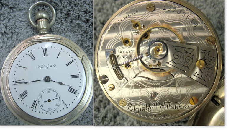

Thanks for trying it Ed, I thought it was time to go into more detail, expecially with Mary Ann goin to school and all. This is the Elgin "all dressed"!
April 19, 2009, 19:04
This has been waiting over 100 years to "ham it up"! What a nice running, clean and pretty "Ham" it still is!

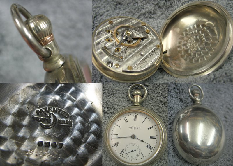

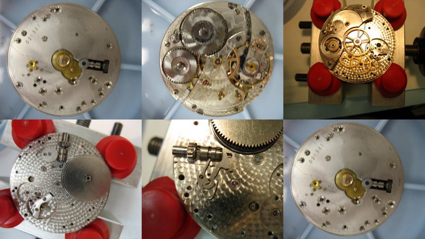

YES, print it please! Also, remember my little "suggestion", I brought my laptop and my digit camera and took some "before" pictures as it was a great help seeing where the parts came from "before", so I could put them back the same "after" Razz. Some actual pictures from my class collaged below . . . (I only use that movement holder now to hold waltham jeweled motor barrels when I unscrew the 2-piece Barrel Arbor)
