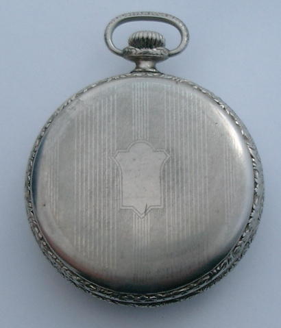

The case is a screw back / bezel and quite ornately chased. Not very worn, mainly to the top edge near the glass and extreme edges on the back, bow still has plenty of chasing present.
Inside the case back, it's stamped " Supreme - I.W.C.Co - 5617248" appears to be polished nickel.
Overall the case is very good, with no damage at all, just a minute burr on one edge of the back where some berk has tried to pry the back of with a case knife! fortunately, no damage to speak of.

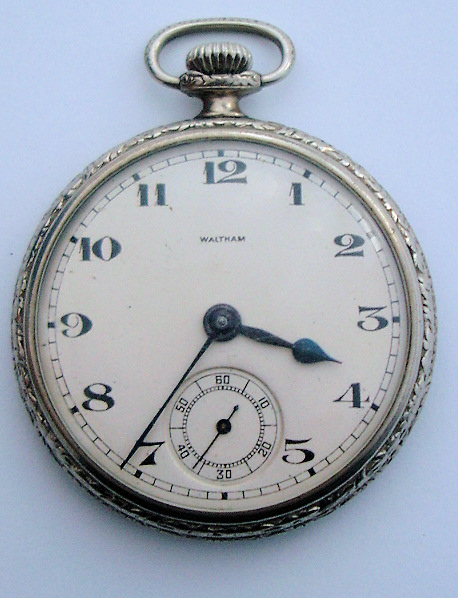

Unable to screw off the bezel yet, but the dial looks as near perfect as I can tell through the glass, has painted numerals and a 'frosted' appearance to the face. Has sunk seconds and one piece dial, doesn't appear to be enamel.

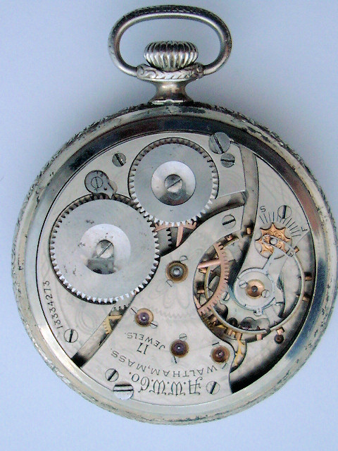

The movement is numbered 13334273, 17 Jewels and engraved " A.W.W.Co Waltham, Mass".
All visible jewels (except the lever) are screwed in chatons with pale Rubies (?)and the balance end stone appears to be diamond. The centre wheel appears to be either gold or gold plated (or some alloy with a gold appearance)? Also micrometer index arrangement.

Waltham face

Case Back
Waltham Case Back

Movement - Downside is the balance staff is broken!
J.W.
Waltham Movement

Dave, I stripped the watch last night to check everything over, and true to form my luck held! Big Grin
Ok, an update:
Both pivots were broken off and no sign of the debris in the jewels, it gets better too - the roller table was loose in the bottom of the movement, and has a shabby looking brass pin fitted which appears to be a botch repair, it’s just a rough brass pin staked into a ‘D’ shaped hole directly behind the notch – I’m assuming it would have had a ‘D’ shaped jewel in there. The table is just a plain flat steel disc with no shoulder or anything, just the pin and a notch, is this usual? It does look deep enough to locate on the staff reasonably securely and straight though.
The staff was loose in the balance arm with only the hairspring holding the beast in place - it fell out when I managed to pry off the hairspring (without mangling it - Razz)!
Some careful staking of the arm will be needed, hopefully it will poise ok afterwards!
Both upper and lower balance jewels are broken and useless and the endstone has a nice crater in it, so either it's synthetic or the ex-pivot was ‘unusually' hard, looks like the end stone wasn't diamond after all Frown
Curiously there's no cap on the lower balance jewel - normal?? No sign of anything having been fitted either.
Can balance jewels be had with their seats as a unit, or is it a re-jewelling job?
The guard pin seems to be a brass hook affair shaped like a question mark - never seen one like that before, may also be a botch repair!
One of the banking pins has also been bent over with a lever or something, why the oik didn't adjust it on it's eccentric I've no idea, perhaps he didn't want to take the dial off (which is pristine BTW).
That's the worst bit over anyway, rest looks ok-ish apart from needing a good clean, doesn't actually appear to have done a lot of work.
I’ve also done a (very) quick test on the underside of the centre wheel, and whatever it is that makes that gold colour isn’t gold; it immediately frothed & went green!
I've several old PW's of a similar age, with balances of a similar colour, none are gold either, but the acid doesn't react at all to it whatever it is!
So, yet another ‘project’ underway!

Dave Coatsworth
Wow! Sounds like that last repairer really knew what he was doing! Roll Eyes
Your roller table sounds correct but, yes, there should be a 'D' shaped jewel in there.
Is the staff hub still firmly attached to the balance arm? Or, is the reason that the staff was loose that the hub is missing? Given the expertise of that previous repairer, I'm wondering if he punched the hub out with the staff. (I can find you a picture of what this is supposed to look like if it looks like something is missing from your's.)
Yes, the lower balance jewel should also have a cap jewel.
Your guard pin sounds correct.
I have a thought... I have a 7J 1899 parts movement. The balance swings nicely and it looks like the staff and balance jewels are in good shape. (The jewels are dirty, so I'm not 100% sure on this.) The only problem is that the roller jewel is missing, but I might also have a replacement if you want to install it. At least this way, you'll know you have a staff and balance jewels that are a matched set. The banking pins are also fine on this movement. What's missing from this movement is the mainspring barrel and some of the winding parts, but it looks like you are OK on this side. The one thing I'm not sure of is whether the material level used in the 7J is the same as was used in the 17J. Maybe one of the Waltham experts in the group will know. Anyway, if you are interested in this, send me an e-mail and we can discuss details.
