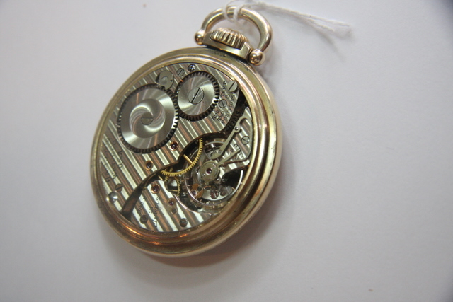

Larry LamphierCase back stuck!
Does anyone have any idea of how to get a case back off. I think that a case screw has loosened, if I tap the back at the three position, I can hear it. I have tried almost everything I can think of like taking the bezel off to be sure the movement is as loose as possable, turning the watch face down and working the cover back and forth gently. The cover is not tightened down tight, as I can move it just a little in eather direction.
It is a 992B in an A case.
Thank you for any help!

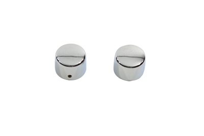

David AbbeI loctite super glue ("control liquid" in grey and pink bottle) my Harley front axle cap (stock pics below) [or a 1 Inch Hex Nut] to the cover, let it set, put a little isopropyl in the "crack" and TWIST!
It always has unscrewed effortlessly.
THen use a watch case opener to "pop" the cap (or 1" hex nut). You will find the residual glue is not hard to shave off with a single edge razor.

David, I like it. I will give it a try in the morning. Can I pick the Harley up in the morning. I'll return it as soon as I'm finished with the caps!!

Larry LamphierWell, I want to thank everyone for there advise. I took your advice Buster and just kept working it with it in the MIDDLE position, and then I would snap it with my finger all around. Long story short, It's OFF!!
These things really work. They stick to the cover so I could pull it up, as Buster mentioned, while I was turning ever so gently on the cover.
October 21, 2011, 00:55
Larry LamphierAnd here is the loose screw!!
Thank you everyone!!
