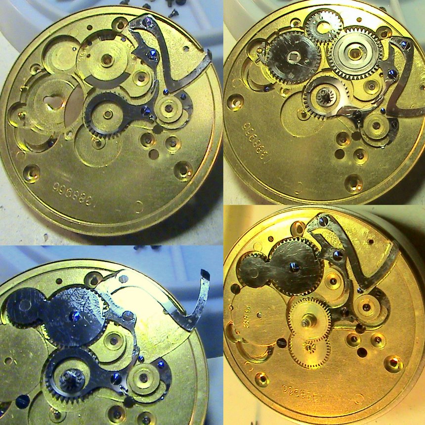

How complicated can you make a Lever setting mechanism? Stages of assembly . . . Thats right, an I.D. fine pitch planetary setting ring and micro tooth pinion on the cannon pinion!
Another interesting design detail is the wavy spring under the "figure 8" shaped winding wheel plate which by friction causes the plate to engage and "wind" by torquing the winding wheel via the winding stem pinion. i.e. the plate "rocks" into wind position when you turn the winding stem.

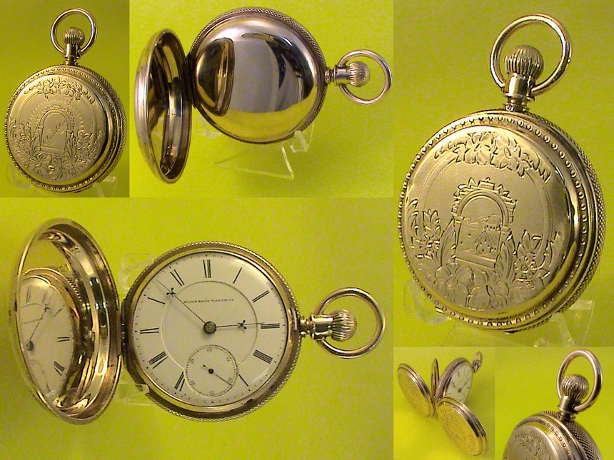

A beautiful original hand signed and ruled dial graced by Fleur de lis hands with a Geneva Stopworks mechanism made "whole" with the Help of the "key" part from good friend Paul in (no kiddin) Elgin Ill.
IHC Life Member
Picture of David Abbe
posted
An extra fine "Drum style" case . . .

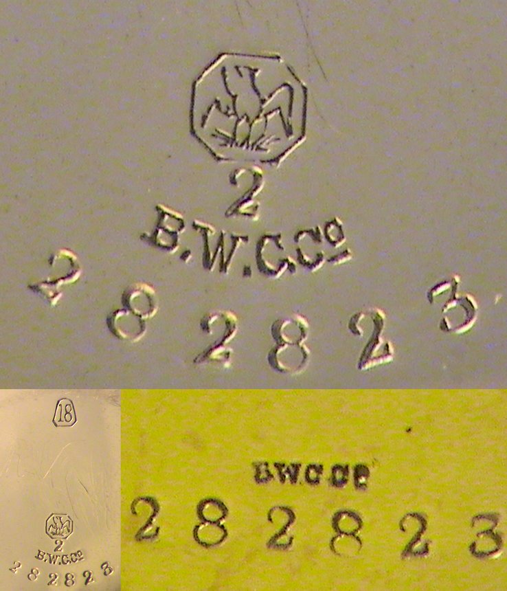

2 Ounce 18K case, Need we say more? . . .

JUST WOW-WOW!!!
So many of us almost take Elgins for granted, this is a truly amazing find!
B.W. Raymond marked "15-Jewels, Adjusted" was a top-notch RR Watch in its day.
Great work David!
