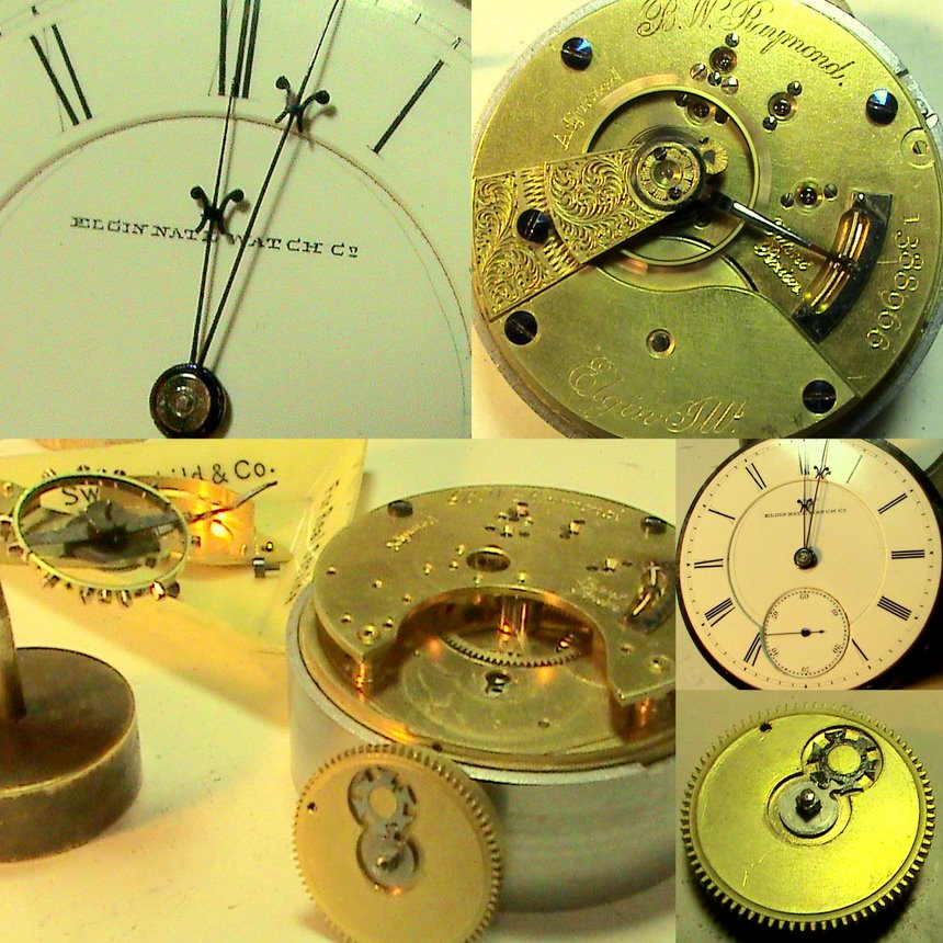

It is finished as you can see below, there was a "1" hiding under the crud on the top plate so the s/n is 1388966

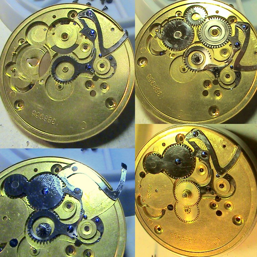

How complicated can you make a Lever setting mechanism? Stages of assembly . . . Thats right, an I.D. fine pitch planetary setting ring and micro tooth pinion on the cannon pinion!
Another interesting design detail is the wavy spring under the "figure 8" shaped winding wheel plate which by friction causes the plate to engage and "wind" by torquing the winding wheel via the winding stem pinion. i.e. the plate "rocks" into wind position when you turn the winding stem.

A beautiful original hand signed and ruled dial graced by Fleur de lis hands with a Geneva Stopworks mechanism made "whole" with the Help of the "key" part from good friend Paul in (no kiddin) Elgin Ill.

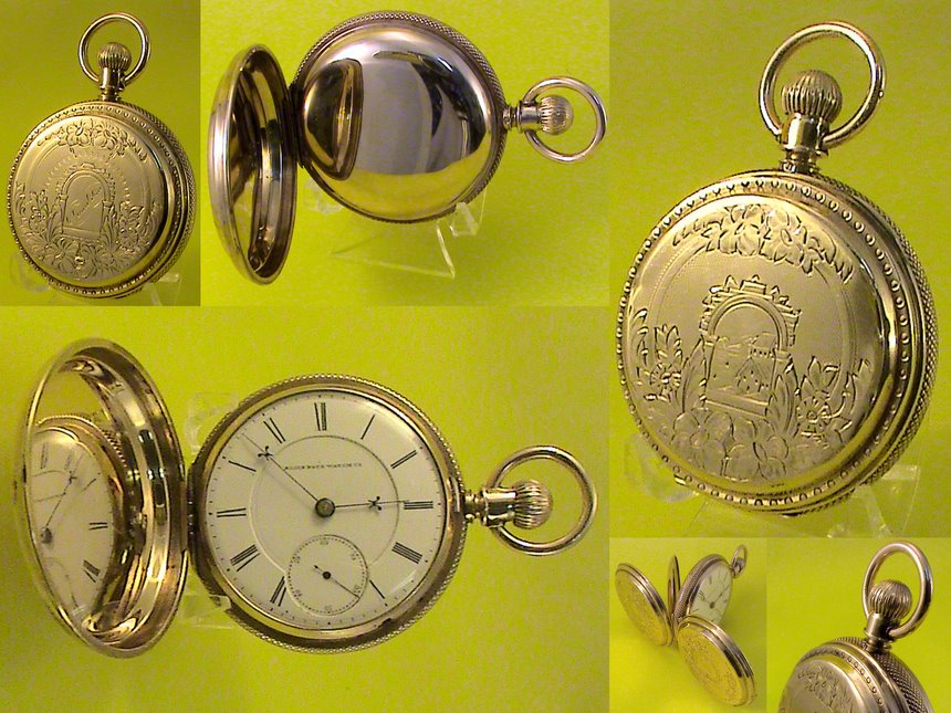

An extra fine "Drum style" case . . .
July 26, 2010, 20:06
2 Ounce 18K case, Need we say more? . . .
