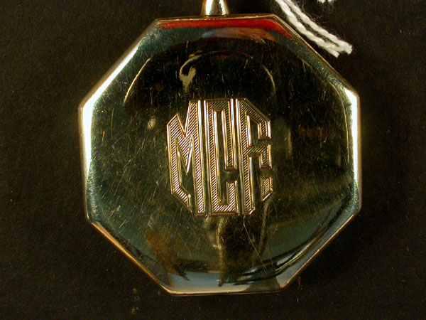

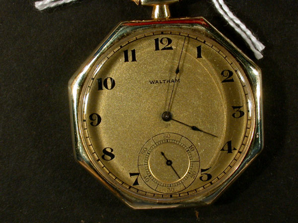

 Jerry - octagon cases are not too common on the Colonial A.  Can you post some pictures? | ||||
 Jerry: Unless someone makes me an offer I can't refuse, you will see this one in Pasadena. but here are two images.  | ||||
 Back.  | ||||
