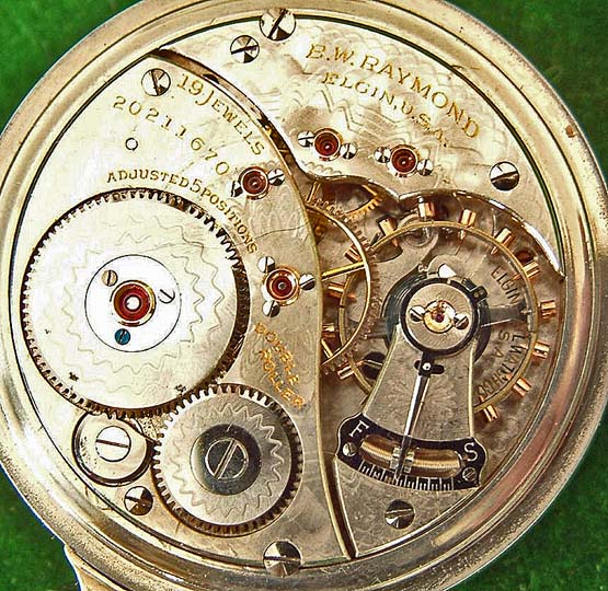

I'm with you guys, the 19-jewel BWR Grade 455 is one of my favorite 16-size Elgin's. Here's another one I like a Grade 372.
19-Jewel BWR Grage 372 from my collection (movement #20211670, circa 1918)

Going by production dates it looks like the 455 replaced the 372 as the BWR model. I wonder what the differences are. In that picture of the 372, it looks like the barrel is jeweled. My 455 just has a screw there.

The 455 would have replaced the 372 and it was marked BWR. The 37x line had jeweled barrels even the 370 (metal type bushing) and both were a5p movement.
The 45x grades basically replace the 37x grades with the 17j a5p BWR being dropped, the 371 19j hunter being dropped, and the 373 21j FT hunter being dropped.
Basically the 37x grades were downsized 18s 3/4 plate models.
