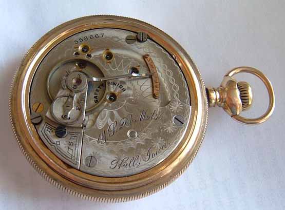

I'm trying to get a 925 out of an open face case.
But, the stem appears to be stuck in the movement.
Am I missing something?

If the stem does not have a wind-pull to set detent in the case neck then it may be held in by a small locking screw you should see exposed at the side of the neck itself.

Thanks for the quick reply Dave,
There's no set screw and I've tugged pretty hard on the stem with no movement outward.
Actually, the movement clears the case okay, but the stem won't come out.
Here's a picture. It's a Reliable case and the stem slot is factory.

Does this movement have a little arrow on it?
Posts: 767 | Location: Los Osos, California USA | Registered: December 12, 2002

Jerry, I don't see any arrow.
Donald, Some good ideas here. I'll try a little oil and let you know how it goes.
Here's the backside picture.
