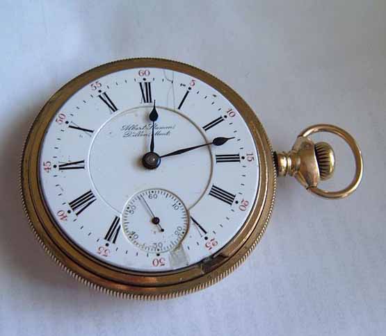

There's no set screw and I've tugged pretty hard on the stem with no movement outward.
Actually, the movement clears the case okay, but the stem won't come out.
Here's a picture. It's a Reliable case and the stem slot is factory.

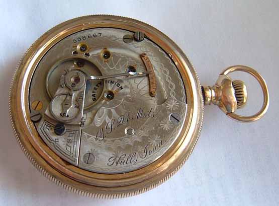

Here's the backside picture.

Paul, Thanks to you and Lindell, the back winding did the trick! I don't understand why, but I could feel it giving way gradually as I backwound it and kept a little forward pressure against it. And it slipped right out.
This forum is great!
Thanks guys.
Note: I removed the balance staff and hands before I started.
