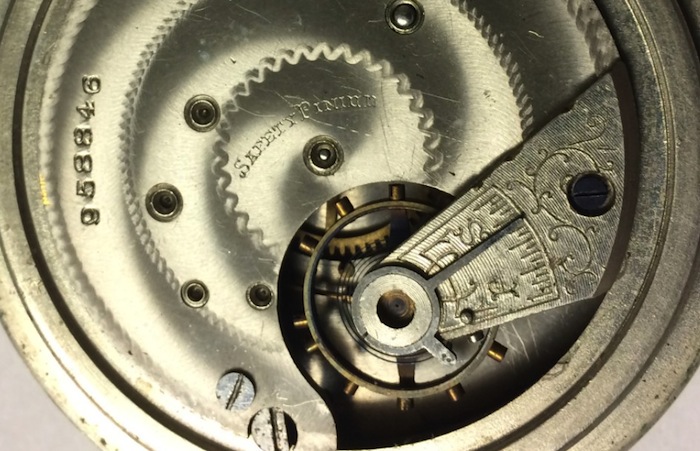

Here's a close up of the movement. Thanks. - Joe

Closer inspection of the balance wheel and Balance Cock in the picture two frames up from this post indicates the balance wheel is uncut, making any adjustments for temperature irrelevant, and also the balance cock which has ONLY a pivot jewel has no sign of the top balance wheel staff pivot in that jewel.
I fear the original balance cock similar to our other pictures was replaced by something else, possibly including the balance wheel from that "something else".

the balance got me off track it is Trenton for sure
