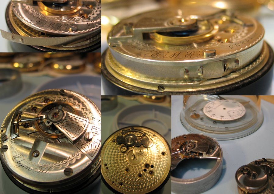

This is the final product after some cleaning . . .

The Bay State watch case must have spent its life doing an excellent job protecting this movement in a tannery, it was a real struggle to clean off the muck. It is worn through on the turned doming of the back cover, but still very functional
IHC Life Member
Picture of David Abbe
posted
The movement was like working in the Elgin Factory, this is MINT!!! Notice the very nifty slide in dust covers. The advantages of these are they are cheaper, and they add a simple "labyrinth" type seal which is a little better.
IHC Life Member
posted
All in all, this watch is a 116+ year old tribute to "excellence in design"

A fantastic all origionl watch. The dial is realy nice looking.

It turned out great, Dave. The dial looks pristine, the case has beautiful engraving and the movement is very sharp. Wonderful find!
