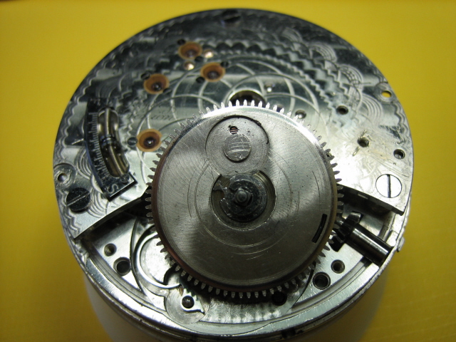

An elgin with an INTACT stopworks all put together!!
After a very rewarding weekend showing one of our brethren how to accomplish "hands on", the compleat restoration of (his) 1883 Waltham (which turns out to be a Can. RR Grade) I came home and started on a Grade 116, 15J 18s BWR (s/n5077835) and What DID I See Eek Roll Eyes Cool . . . a REAL (not thrown away by some old Watchmaker) COMPLEAT Elgin 18s Motor with Stopworks!!!! Smile Big Grin Wink
More to come! . . . .

Thanks, Ed. I read the other threads and it appears that, as the stop works was not deemed a critical part by some watchmakers, they just threw it out after servicing a watch. What a shame as the original manufacturer thought it was important enough to incorporate it into what appears to be higher grade watches. I'll be on the lookout for numbers within your serial number ranges.
March 31, 2009, 13:08
Mary Ann, as the stopworks required some thought and study by the watchmaker to learn to "unload" and "reload", many of them simply did not care to spend the extra time and tossed out the parts costing the user the 30% or better reduction of "isochronism" errors that were allowed by the more expensive factory installed stopworks.
That is why I am so happy to discover one "survivor" to keep with my collection for that fact alone.

The movement was like working in the Elgin Factory, this is MINT!!! Notice the very nifty slide in dust covers. The advantages of these are they are cheaper, and they add a simple "labyrinth" type seal which is a little better.

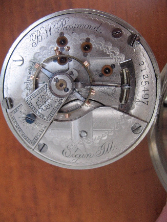

Here is one of my BWRs. I don't think it has the stopworks feature. It is a grade 27, I think. I always thought the serial number looked odd. Why do you suppose that is?

According to information I have yours should have the stop works.
April 02, 2009, 12:01
Mark Cross
Steve, it looks like the last 4 numbers are larger than the first 4 on your BWR. Is that how it actually looks in hand?
Regards! Mark

I agree Mark and I believe that is what Steve is referring to, right Steve...?
What ulterior motive would make some one change the last 4 digits of any watch's serial number unless they wanted to try to fool someone.... Big Grin
I don't think I could trust that # unless I saw it happening frequently in other watches....

I would have to do some looking to find examples but I think Elgin did stamp some of their watches like that.

Steve, Your BWR is actually a first of that series and is adjusted. I think the numbers on it are legitimate and when the parts were released for production, the stamp fonts that were used to record the series were slightly different for that 4 digit set.
Look to see if the same numbers are on the Balance Cock, Barrel Bridge, and (possibly) the balance wheel. Aslo, your Gr 27 was shown by Tom's listing to include some Stopworks motors.

Well, I wound this thing up, and it stopped quite dead at the end. Now I can't wait to have my watchmaker look to see if it really has a stop work mechanism.

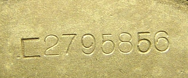

The number on the dial plate
dial
