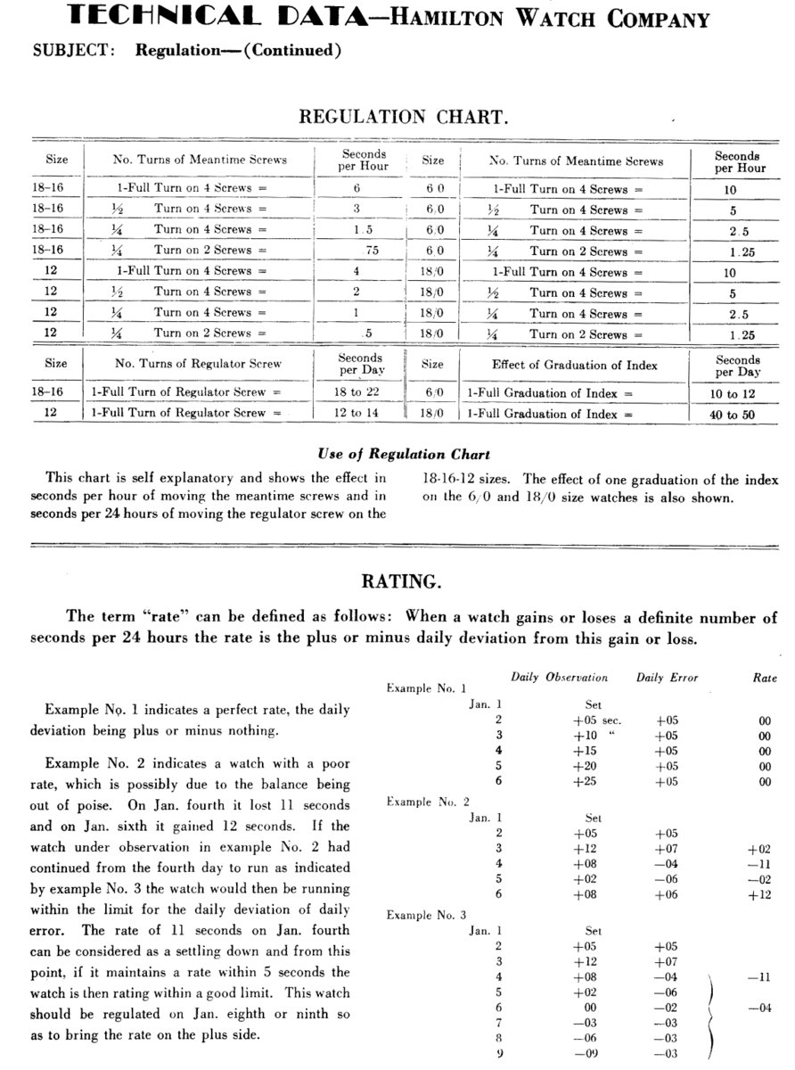

David AbbeFor which the "learned" watch service person may want to refer to these "notes":
Note that Hamilton describes "accuracy" correctly as mean deviation. A very, very important point when discussing watch accuracy and adjustments!February 01, 2013, 13:12

David AbbeI use the Hamilton Regulation chart all thr time when timing watches that have Mean time screws, in general though, I have better results manipulating balance weights for deviations that exceed 2 minutes a day (5 sec/hour)and then "fine tune" the timing with mean time screws or micro-regulator.
