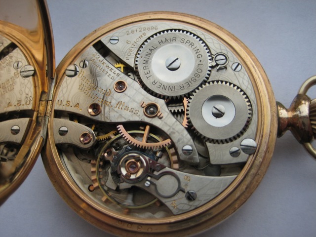

Derek Ramsdale
And here`s the Waltham WI movement.

Steven Ford
Great looking Vanguard ,Derek, I like those heavy Roman Numerals.
Steve
