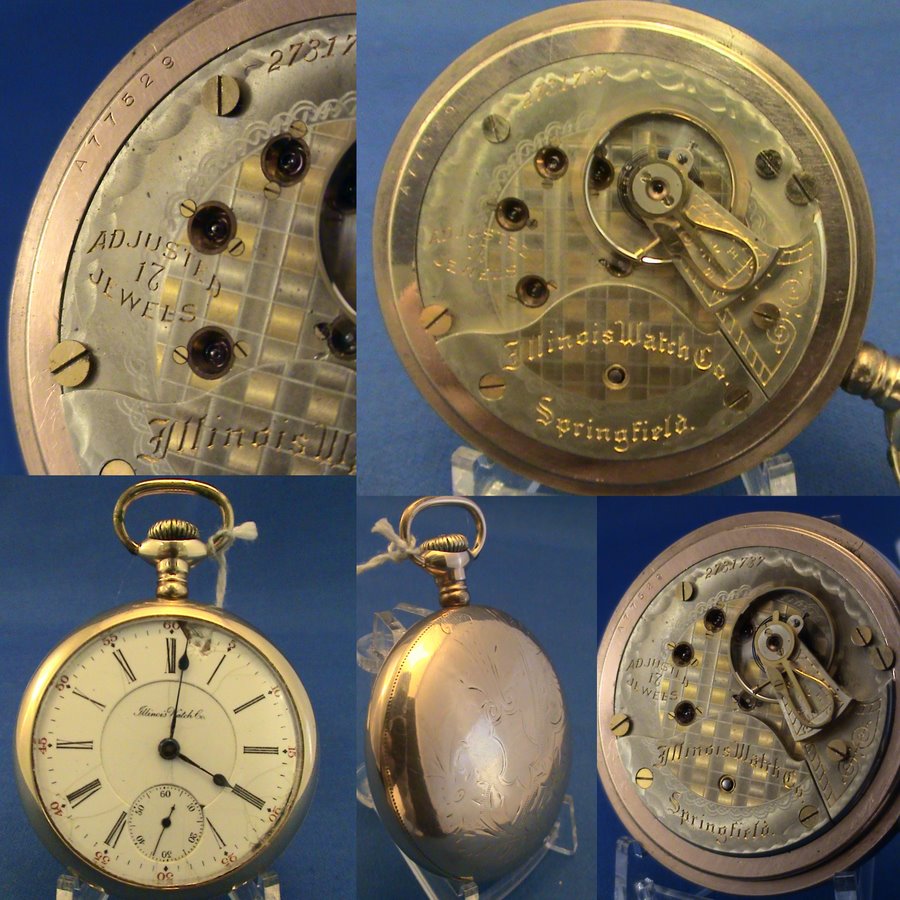

This very fine Illinois 18s two tone 17J Adjusted watch had only one "defect", a War Plastic crystal. Sadly on its "last ride" ("humming along" and vibrating in the trucks and airplanes, etc., etc.) to my place the ruined and rusted hand particles ground off a considerable amount of the Arabic Black Enamel Arabic Hour marks on an otherwise fine double sunk dial. When you get a watch with a "yellowed" crystal IMMEDIATELY pop the crystal out and send the bezel to William White for a top quality Glass replacement to avoid seeing RED! ![]() | ||
Ouch! That one hurts! Does the center wheel arbor have damage, too? The rust looks pretty extensive. Let us know how the clean-up goes. | ||||

Mary Ann, I sent the dial to International Dial for them to see if they can clean and re-number it, meantime I put on an ishy replacement dial new hands and a mainspring I have this . . . which will be further restored and cleaned up and made as "spiffy" as possible.(s/n 2731737) ![]() | |||
Dave - glad to see that the movement wasn't damaged. | ||||
| IHC Life Member |
The movements are (In my opinion) "protected" by the watch hands oxidizing first (unless immersed in salty water) from humidity. This one was pretty tough, but fortunately nobody had tried taking the hands off so I did it with enough TLC to even be able to use the "stumps to measure up a new set of hands from my Elgin cabinets. (Just like many watchmakers-past must have done who just wanted nice matching hands.) The dial I put on it will actually clean up and repair pretty well. So it may stay on this movement because it has the right signature. The Grade 89 movement is referred to as; "Gold Inlay Engraved and two tone Gold Nickel Checkerboard Damaskeened movement with Gold Plated 'Patent regulator' and polished gold plated plate screws." Adjusted to three positions. Double-sunk Glass or enamel dial signed "Illinois Watch Co." This finish treatment with all the Gold hardware was rarely done. | |||
