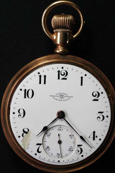

Here's my 999 19 jewel from 1906 with what I assume is the original dial. I thought it was interesting (unfortunate) that it has also has a chip next to the 8. I was lucky to be able to find a really nice replacement dial but not so lucky with what I had to pay for it.
Mine has a broken balance staff - is that the same one used on the 944? Bob

I would bet there is a dial post under the damage on both dials, you see that often from people not unscrewing the dial screws enough and/or prying the dial off.
posted
You are right Tom. There is a dial foot right under the chip and a little of the porcelain on the back is broken off around that foot.
