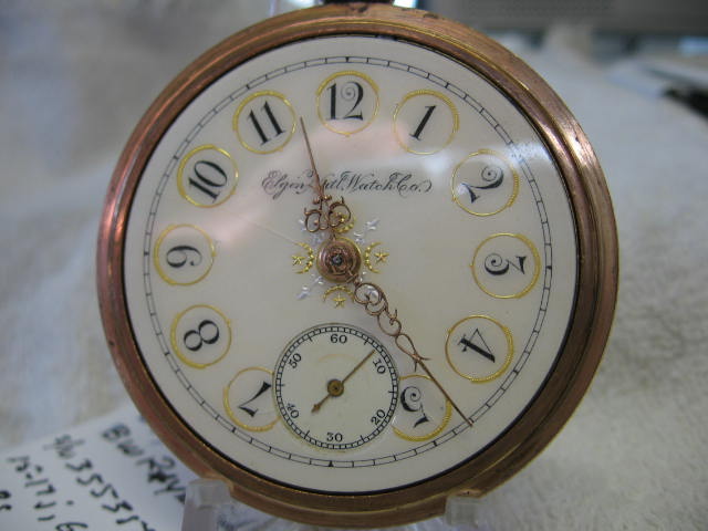

Thank you very much Keith, I am now pleased to show of my latest acquisition once again only this time with the correct gold hand, thanks to you.
Keith was kind enough to send me a gold hand for my newest watch and thanks to him it now looks terrific. So, thank you Keith, very much, and as promised, above is a look at that fine gold hand you sent me, with my Elgin underneath.

That looks different as night and day!
Smile
Regards! Mark
Posts: 3841 | Location: Estill Springs, Tennessee, USA | Registered: December 02, 2002
posted
Yes, it sure does Mark, and I think it's much nicer this way too.
Bud
Posts: 449 | Location: Ontario in Canada | Registered: September 28, 2010
Picture of Mark Cross
posted
Agreed 100%!
