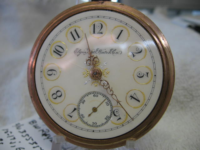

Jerry King
Bud, the hands that you are looking for will be the Elgin #2416 Louis XIV and are solid gold and the other one will look like the one you have now only it will be gold plated and it is a #2605....
You may want to check with Brian C., he may have one....To bad I didn't know about two weeks ago that you needed one, I gave one to a friend for his 18 size Elgin BWR....
That is a nice GM Wheeler and I think they are very underappreciated....
My BWR with a similar Dial....
