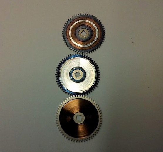

heat and lathe experiment final product
messing with lathe and heat on some ratchet wheels.
October 12, 2014, 17:41
Patrick Wallin
Peter,
It looks to me as the heat effected the teeth more so than the wheel except for the bottom wheel.
I often wondered how heat would effect a bent staff.
Patrick
October 12, 2014, 23:34
Harry J. Hyaduck Sr.
Looks pretty neat Peter. I really like the brownish color.
Harry
October 12, 2014, 23:41
Peter Kaszubski
yeah the brownish looks like amber or good beer in real life hehe.
October 13, 2014, 00:13
I heard the the brown and blue colors come from the difference in the heat temp. applied. I don't know if that is true or not.
October 13, 2014, 01:59
Peter Kaszubski
the brown is from reheating again to blue temp.

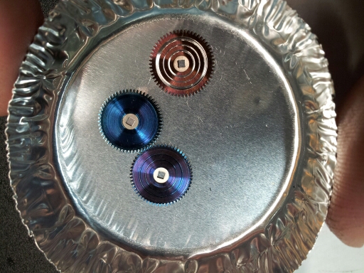

October 15, 2014, 01:36
Peter Kaszubski
another batch
October 15, 2014, 02:09
William D. White
Nice going peter. I like the one on top. You should experiment with some diamond compounds if you haven't already. After your lathe work, you could start with 5 micron, then go to 2. finishing with 1/2 micron will give you a mirror finish that you could then color with heat. Here's where I've gotten mine in the past:

October 15, 2014, 02:51
Peter Kaszubski
Thanks William that was my next step to get mirror
finish but could not find the place for the compound.
October 15, 2014, 05:48
Dan Carter
Cool idea Peter. I used the bluing machine built from specs in one of the posts here to make my ratchet wheels blue. I will say that the mirror finish is critical and that the different temps give you the colors (570 degrees F gives you deep blue). I used multiple grits of sand paper from 800, 1500, 2000, then polished with semichrome with a dremel until I got the mirror finish (will have to look up the diamond compound now Smile. There are a few example pics too of some nice blue screws and ratchet and crown wheels if you want some ideas. I will say though that the lathe puts some nice record lines on the wheels for a nice effect! And the Amber color is nice too. I think what I like the most though is the breakup in color with the silver lines! Nice work!

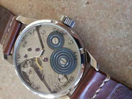

pic of finish watch
looks better in life

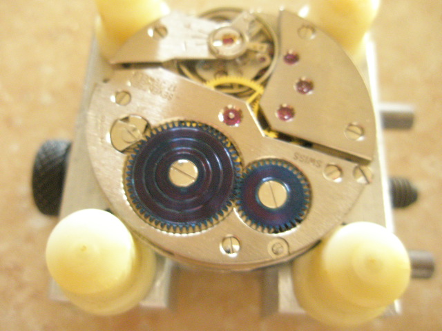

October 16, 2014, 14:06
Peter Kaszubski
another one done
