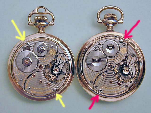

Let's start with what you do have first..
Here is a picture, look at the case screws and where they are. In the picture a Ball Hamilton is on the LEFT and a Ball Waltham is on the RIGHT.
I think you will find you have a Ball Waltham. And in that case, you will need a Ball Waltham dial to swap out, as they do not interchange.
As to the dust ring, they are generally only hand tight. In any advent, remove the case screws, take a blade and work around the edges until it slips off.
<Ball Hamilton on LEFT ~ Ball Waltham on RIGHT>

Thanks Buster will try that.Case screws at 11 and 5. Roger

There's a little glitch going on in this post that needs clearing up then we can say " next post " and move on !!
In the title Roger says "Just Received Ball Hamilton". Roger stated serial number B206622
That would make it a Ball Waltham as their blocked numbers in that series were B202001-B225000 from ca. 1904-1906.
On the other hand, Ball Hamilton 16sz. grade "999" serial numbers started with
B600001 around 1910 and ended with B655200 in about 1943.
Now, Roger says his watch has case screws at 11 and 5 o'clock Eek
I believe there are two errors in this post. First, I believe it is a Ball Waltham "if" Roger quoted the correct serial number. Second, Roger stated his watch has case screws at 11 and 5 o'clock. Looking and holding Roger's watch up exactly as in the two side by side pictures that I posted and saying that the crown wheel is at 12 o'clock, then Roger's watch should have case screws at 1 and 7 o'clock just like the pictured movement on the RIGHT >>>> Big Grin
I don't want someone confused in ID on a watch so perhaps we can clear this up. Also Roger successfully swapped out the dial, but it was with another Ball Waltham dial I do believe.
What do you say Roger ??
Posts: 6378 | Location: Texas in the USA | Registered: July 27, 2009
posted
Buster you are right.Looking at the rear of watch the screws are at 1 and 7.From front they are 11 and 5.Sorry for the confusion.Thanks Roger

Whew !!
Perhaps the most confusing was me trying to explain all of this and express it on paper Smile
I was beginning to doubt myself Eek
If nothing else is garnered, we can see how important pictures are to a post. And when trying to ID a mvmt, and looking/describing a mvmt, forget about the dial side as to a relation of hours because.....
That's the other side folks Wink
The title to this post has now been changed to " Just received Ball W-a-l-t-h-a-m" Thanks !!
