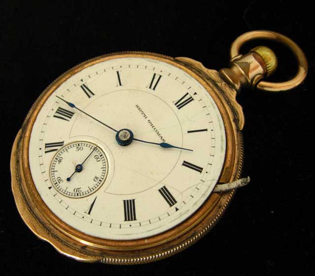

HELP! I JUST BOUGHT THIS WATCH THINKING A "SMART GUY" Eek LIKE ME COULD EASILY GET THE CASE OPEN USING MY PROFESSIOAL GRADE RUBBER CASE OPENER (NO) OR A CASEOPNER BLADE (NO,NO IT IS NOT A SNAP OFF)OR SHEER STRENGTH (NO,NO,A THOUSAND TIMES N0!). I HAVE THOUGHT ABOUT PUTTING IT UNDER A STRONG HOT LIGHT FOR AWHILE TO EXPAND THE METAL BUT I AM NOT SURE IF THE ADDED HEAT WOULD DAMAGE THE WATCH SINCE I DON'T KNOW THE TYPE/MODEL OF M0VEMENT OR WHETHER IT IS ADJSTED TO HEAT/COLD. ANY IDEAS Frown

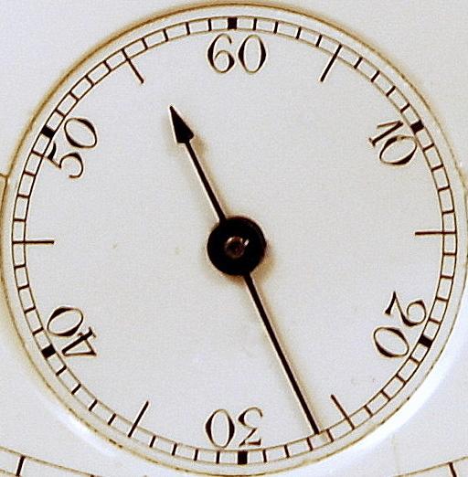

Eric Unselt
I was watching that one all the way, John. The tip-off is usually the hands - Seth put the chunkier spade hands went on the cheaper watches, while the more slender spade hands (like the auction example) were used on the higher grades.
Secondly, that's a genuine porcelain-enamel dial, not a faux Swiss pressed dial found on the lower stuff.
But the real indicator is the seconds hand. The lower-end Models 6 through 12 got the ball-end seconds hand, while the arrow-end hand (below) usually went on the Models 2 through 5.
I'm very curious to see what's under there. My guess is a gilt Model 3.

February 01, 2012, 18:56
John sent it to me . . . I opened it. Firstly the case . . . (new Xtal)
February 01, 2012, 19:02
#836 made and dellivered in First Year (1885) production Model 1. VERY RARE and collectible. Should be OK Mechanically but needs a new balance staff.
February 01, 2012, 21:25
John A. Grennan III
Thank you Dave. I am eager to know all about it. dis the casw survuve the opening well. Looks like a little dent in the photo.
February 02, 2012, 00:12
The "dent" is a reflection of the camera. The case is allo-sameo but now can be opened at will. I directed my miniature gremlins to crawl under the dial and around the backside to detonate their non-volatile bad smelling salts of a non insulting nature but which cause the case to open its recalcitrant backside and let out with a "WHOOP", whereupon I sneakily grasped the case cover before it closed again and held it open whilst squirting in some miracle lube (isopropyl alky) upon which it gave up and stayed open with a "wheeze". Cleaning and fixing might take longer.
