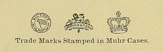

Here is the Muhr crown from an 1899 catalogue.
By "Scheme" cases I assume Muhr means in the letter that someone made cases of a lower quality than Muhr but with a mark similar to Muhr, correct?

Lorne,
That description of "Scheme" sounds correct to me.
Here is the definition from Merriam-Webster; Scheme: a clever and often dishonest plan to do or get something
That article above is confusing to me.
I have yet to find anything associated with Cronin cases being anything other than gold filled.
The point I was trying to make here, like others have mentioned, is electronic equipment is usually not an accurate way to test for gold.

posted
It seems every one used the Muhr crown and attributed it to Cronin. They are wrong. If you cannot read the initials, it is MHC stamped upon each other.

Jerry,
The article above is stating that people were attributing the Cronin trademark to Muhr. It appears people were sending their Cronin cases to Muhr. The Cronin trademark, whether in illustrations or on your watch, has a crown and a star associated with it. On the other hand the Muhr trademark has the crown and a cross.
In any event the conclusion here is the electronic method of testing gold is not accurate. Clearly the Cronin case has no marking indicating anything other than ‘Warranted’ which is consistent with a gold filled case.
If you think the case is something other than gold filled then have a competent jeweler or watchmaker evaluate the case. The gentleman who used to own the watch and jewelry business in my town could usually “tell” if something was gold or gold filled by the way it looked and felt.
Another option is to take the case to a competent jeweler who buys gold and see what they have to say. If they suspect the case has gold value they’ll want to take a file to it and do some sort of “acid test” to find out what it’s made of before they give you an estimate.
