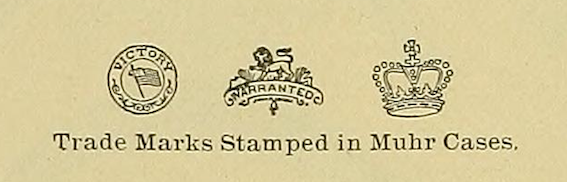

Here is the Muhr crown from an 1899 catalogue.
By "Scheme" cases I assume Muhr means in the letter that someone made cases of a lower quality than Muhr but with a mark similar to Muhr, correct?

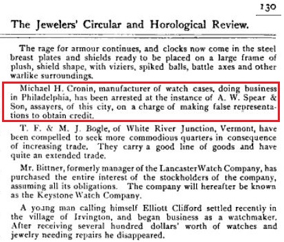

Here is some information on Mr. Cronin.
RR
1184 The Jewelers' Circular and Horological Review , Volume 15

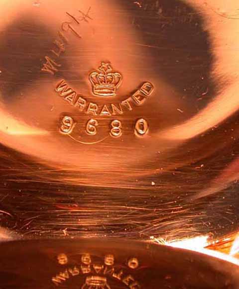

See photo of crown
June 22, 2014, 14:47
Jerry Freedman
And initials
June 22, 2014, 14:51
Jerry Freedman
It seems every one used the Muhr crown and attributed it to Cronin. They are wrong. If you cannot read the initials, it is MHC stamped upon each other.

The article above is stating that people were attributing the Cronin trademark to Muhr. It appears people were sending their Cronin cases to Muhr. The Cronin trademark, whether in illustrations or on your watch, has a crown and a star associated with it. On the other hand the Muhr trademark has the crown and a cross.
In any event the conclusion here is the electronic method of testing gold is not accurate. Clearly the Cronin case has no marking indicating anything other than ‘Warranted’ which is consistent with a gold filled case.

Here is another case with the same marking that I would not think to be solid gold.
