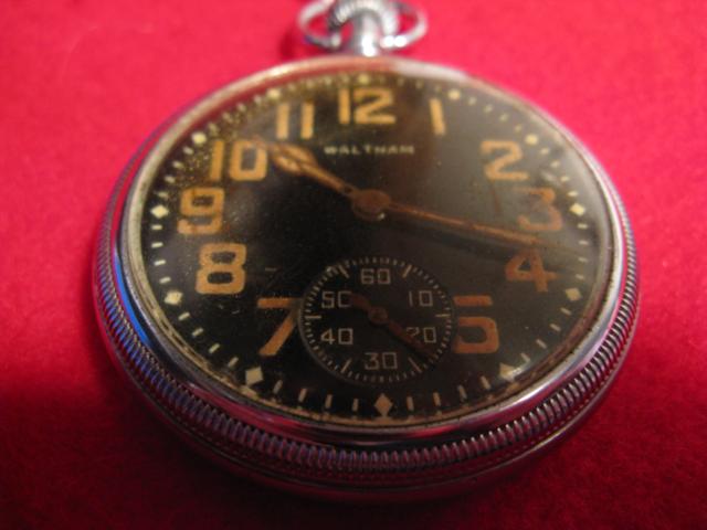

Bill Manders
Hi Jim,
Here are some photos of this Waltham. It does have a radium dial, so I am being careful about ingesting, inhaling residue from the watch. I understand the half life of the material is about 1900 years.

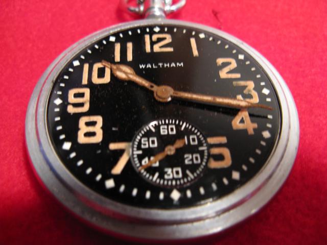

Bill Manders
dial 2

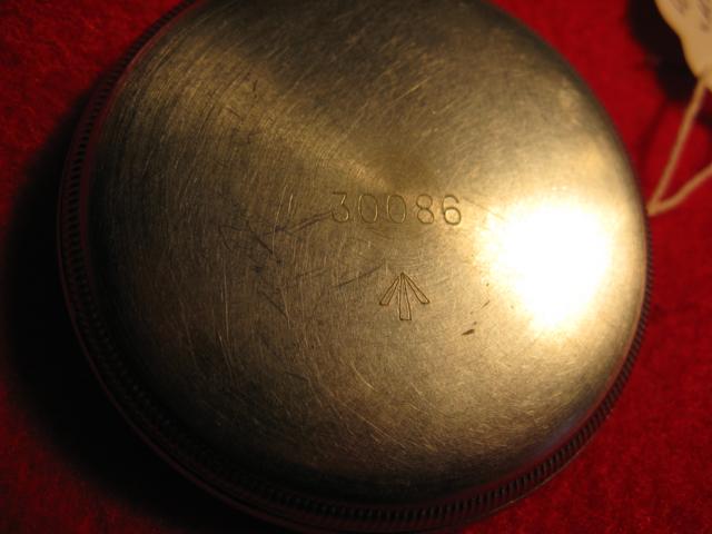

Bill Manders
back case

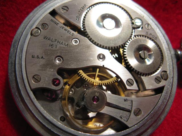

Bill Manders
movement. There really does not seem to be a lot of information out there on the military issues. I was led to believe the case numbers were assigned to a particular person ? But have no way of finding that out. I have since found I think it is a Mdl 1908? Also is is American or British issue ?
Bill

Mike Sandell
The marking on the back cover the arrow is English military,It's a waltham there were two model's 1609 and 1617 I think it's a 1609 model and it's a 9 jewel,stem set and wound and the price waltham sold them for 12.50 plus 0.15 engraved for the first lot of 10,000 watches.And from the serial no it was made around 1944.

Mike Sandell
On the US one's they had Ordnance depatment USA and number on the back the english all ways had the arrow and black dials on there issued waltham's I have a Helvetia that is English Military here a photo of the back you can see they did a better job on yours.

Jim Hester
There are quite a few different markings on WW II era British military watches. GS/TP is one, but there are a number of others such as the markings on your Waltham. The markings on your pocket watch indicate it would have been intended to be issued by the Royal Navy - though of course it is not a deck watch or comparing watch since it is only 9 jewels. Still, these are nice watches.
The rust on the hands appears to be something about which you will not be able to do anything. Trying to remove it would dislodge the radium. Also, cleaning it up would make the hands look like they did not belong to the watch give the overall patina. My suggestion is to leave them as they are. I think they give the watch some historical flavor in that they might have aquired their rust from being around some salt air of the sea. There is no way to tell if this is the case, but it makes for some nice thoughts about how this watch may have actually been used.
As for determining the man to whom this watch was issued based on the serial number on the back - that is not possible. I understand that such records were never kept given the enormous numbers of timepieces that were issued and the pressing needs of keeping supplies flowing quickly during the war.

Brian C.
Bill,
If the crystal on your watch is a yellowed plastic one, it needs to be replaced with a new one. That is what will cause your hands to rust. The newer plastic crystals, don't turn yellow.

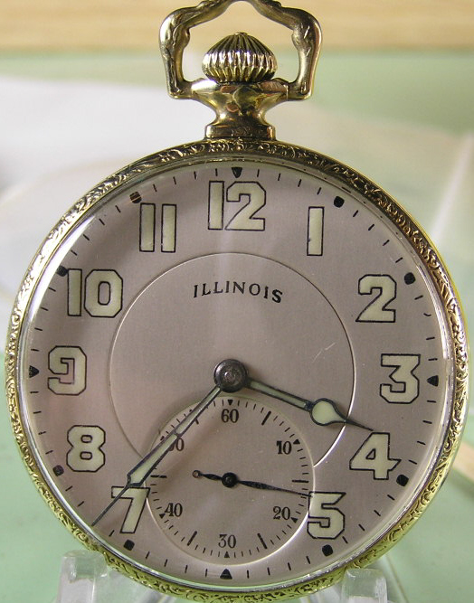

Steve Middlesworth
Bill,
Here is a luminous dial and hands that was done by them for me. It was pretty nasty originally.
Steve

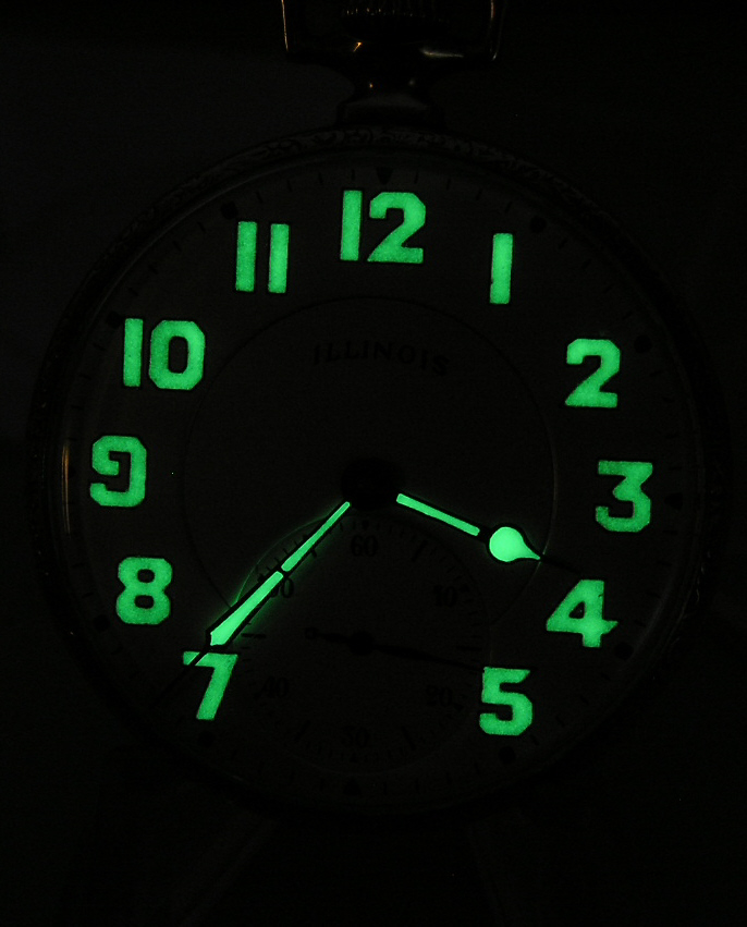

Steve Middlesworth
And here it is after it has been "charged" by a light source.....

Bill Manders
Steve,
Thats a beauty, nice looking watch and spectacular refinish.
